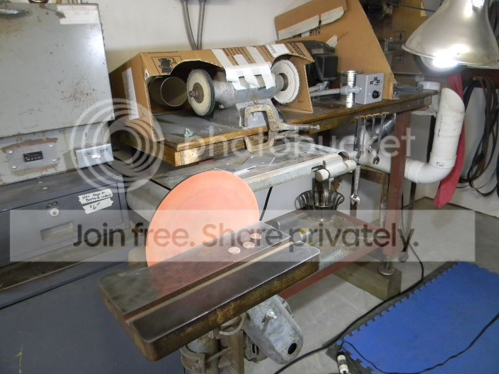

I use a shroud around my KMG. I used card board as an experiment and never changed it. The dust collector is outside the shop and there are two 4" exhaust ports the one in front is just a slip fit so it can be replaced by a water bucket the other is in the back , hard to see.
The system is used only when grinding non spark generating stuff.
It works very well, keeps the shop clean. I also extended a port to the buffer with a similar cardboard shroud.
The switch for the filter and supplied air respirator are at the upper right of the picture.
I also made a couple of rubber flaps to contain some of the debris thrown by the belt.

Patrice thats great, it will work and looks piece of cake to rig up. I like the fact with the clear plastic you can see thru it.
Mark excellent setup. I think I will use your prototype and go straight to something in sheet metal. I think with your setup on the buffer will work perfect with a couple sheets of plastic that can be dropped down to cover the front up while working with other stuff to keep any particulate from landing on the buffer wheels. Oh and I wouldnt mind having that disk/belt grinder of yours.
