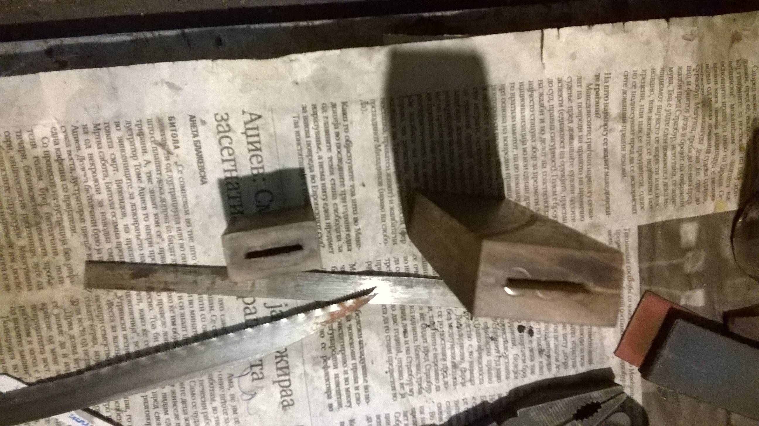

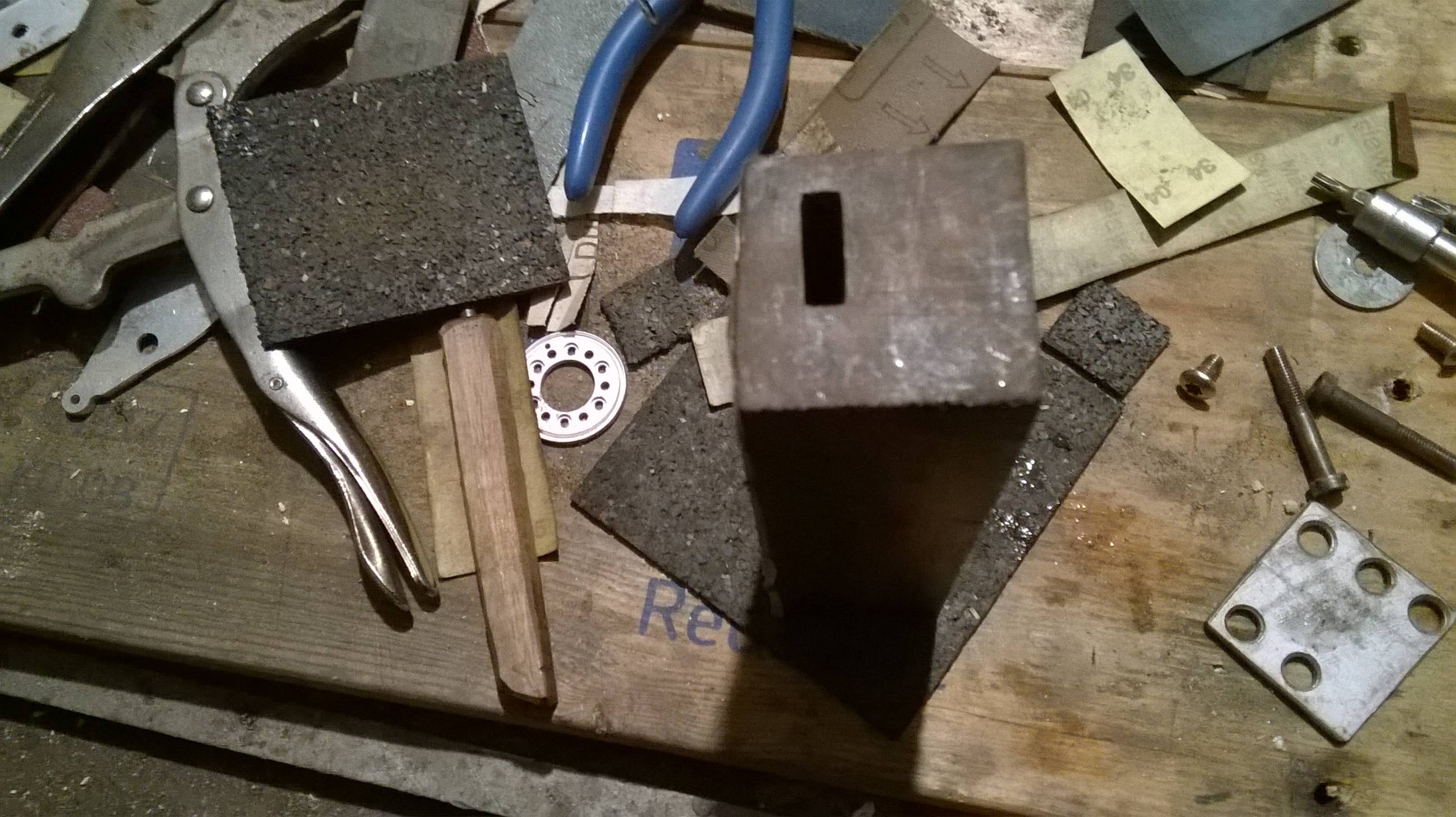

I drew the tang on the blank, drilled a center hole with a long aircraft twist drill bit, then broached out the tang profile.

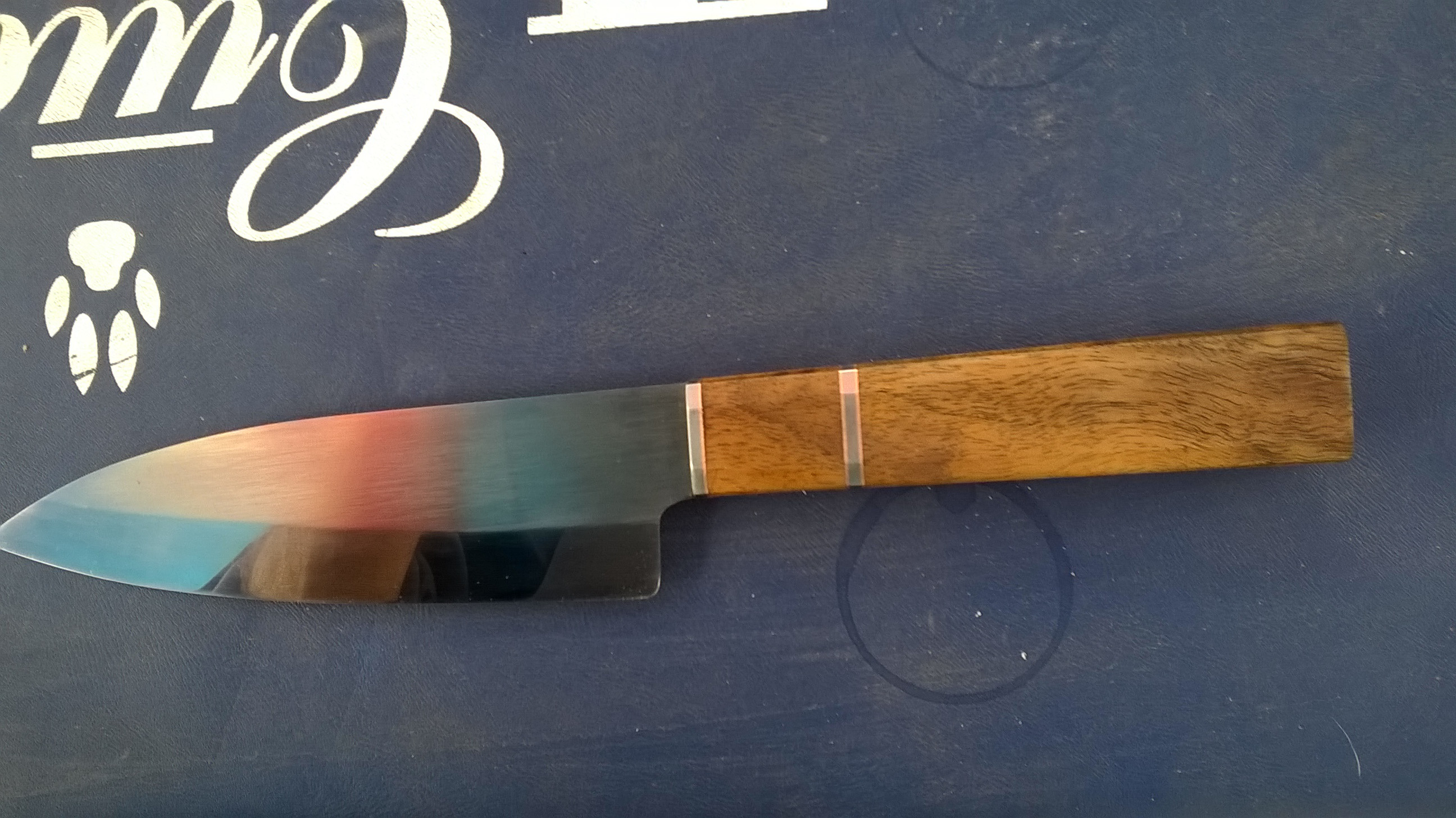

For 1.5mm thick blade , 1.6mm in wood :)
This is 5.2mm in wood for 5mm tang , I like it tight .
It's late here , tomorrow I will take picture of all tool I use for tang hole :thumbsup:
