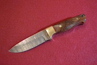

I have some hardened AEB-L kitchen knife blades and I have decided that I want to put bolsters on one or two of them. What kind of drill bit or end mill should I use to drill 1/8 inch holes and what is the process for drilling them?
JDM61, About the only way to drill hardened steel is with Tungsten Carbide drills. You will probably break a couple in the process because they are brittle . I have a whole collection of them and my opinion on the best place to get them is this: Go online to Drill Bit City and look at the left side of their webpage and find the link to Drill Bit City II and there you will find reground Tungsten Carbide bits in fractional sizes and you can buy them in 5 packs. I have been using these for years. If you blade is too hard ( like Rockwell 62 or more) then you are out of luck I'm afraid. I have put bolsters on Damascus knife blades that I have purchased and I had to put heat sink paste and clamps and all the vise grip clamps I had for heat sinks and heat the tang area with a torch to soften enough for drilling. The heat might leave heat marks on your ricasso. Give it a try because you can always use the drills later. I hope this helps you. Larry
