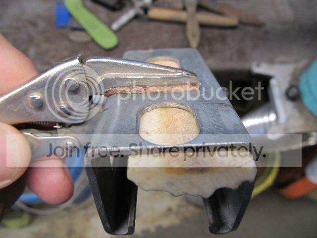

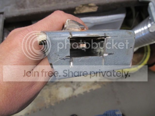

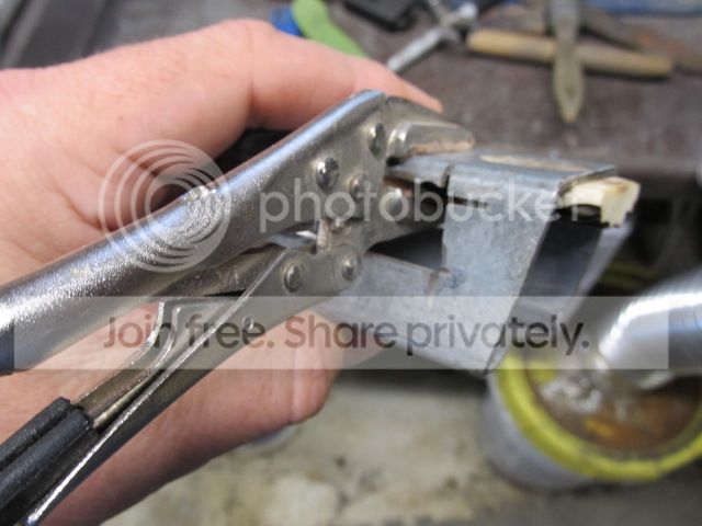

I'm soon going to have to drill thru uneven materials stag/ bone etc.
I was wondering how to drill thru the liner side out thru the bone ???
With the bone being uneven I cannot rest it on the drill press.
So I read somewhere I'll need to build a cradle to hold the flat liner up.
If that makes since...
Any pics of jigs would be helpful.
I tried to google it but I don't think it's even fit a name.
Thanks
Manny
GRS sells Thermo-Loc plastic sticks which can be melted and formed into cradles for irregular parts. Then they can be used on the next project.
Nothing fancy, but it works. Some u channel that is notched large enough for small vice grips which have leather glued on to the jaws. Also works for dovetails.

Here is a chunk of channel iron I use, Milled both the bottom of the channel
and the legs of it flat on the same setup. Ken.
square tube simular to the guys above
