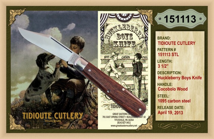

Droopy blades - pet peeve
I agree with the OP, I don't like the downward angle either.
As Kootenay said, I think it is to create a belly, using the blade angle geometry.
This may illustrate my point. This design both concepts, belly with a straight blade spring alignment.
I did not mean droop to create a belly. More that the 'droop' puts the distal (tip) end of the blade in the right place for it's intended use.

This "drooping" is not a flaw. The knife is designed to have the blade in this position when fully open. Depending upon handle size and shape and blade profile, this position of blade angling down slightly can be more ergonomic for the type of cutting that blade is intended for. i.e. could be a better angle for whittling but not good for slicing.
All knife companies have some patterns in which a blade is angled when fully open. This is intentional as it puts that blade in the correct position for use. If you don't like it then most likely you do not do the type of cutting it is intended for.
It's certainly the case that some blades are deliberately set at an angle on some patterns, but in my experience the angle of the blade can vary on the same pattern from the same manufacturer, on one knife the blade sits out straight, on others it droops.
I don't mind it, depending on the blade shape. I think it can be functional in angling the edge toward what you are cutting. But if you don't like it you can just grind the back of the tang where it contacts the spring a bit. Easy peasy! Good luck!
