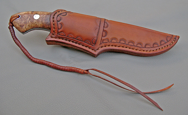

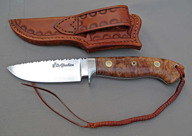

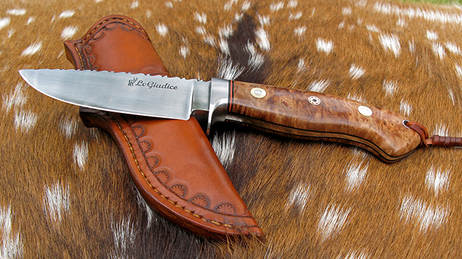

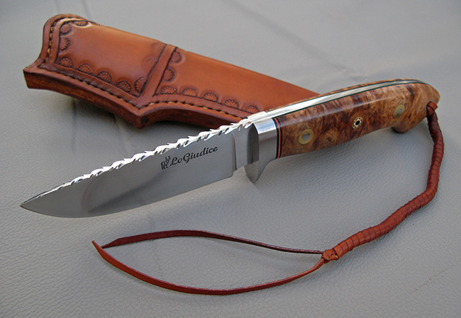

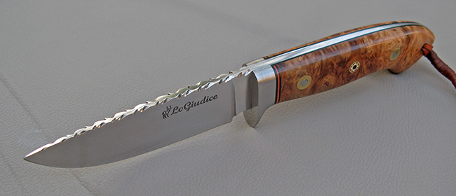

Another hunter that I recently completed:
Comments and critiques are welcome.
Style: Drop point Hunter
Overall Length: 8-1/2 inches
Blade: 3-7/8 inch, 62 Rc. CPM 154 stainless steel, flat grind, 800 grit hand rubbed finish, tapered tang
Blade Thickness: 0.173" at ricasso
Handle Material: Amboyna burl sapwood, Spacer: black vulcanized fiber
Guard: 416 Stainless Steel, Spacer: layers of black and brick red vulcanized fiber
Fasteners: Loveless screws, mosaic pin, & stainless steel lanyard tube
Lanyard: Saddle tan kangaroo skin lace
Sheath: Hand made by Mike LoGiudice, saddle tan with dark brown antique finish, sealed
Thanks,
I DO like that, the file work and mosaic pin are very, very nice. The sheath is pretty awesome too. A real nice combination each complimenting the other
