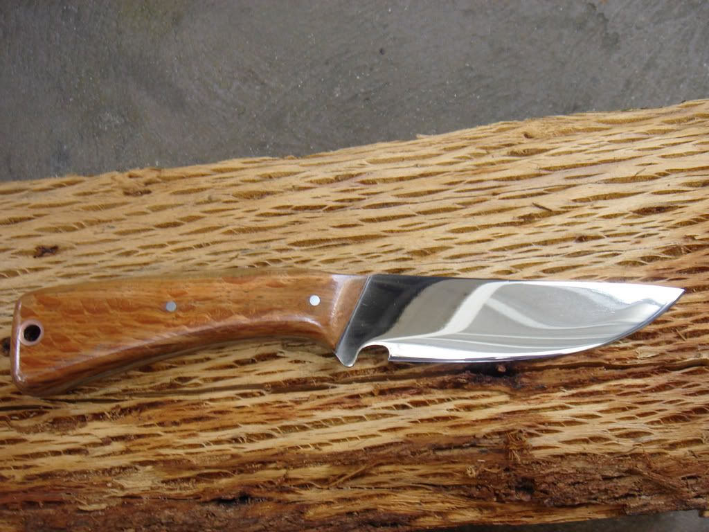

I just finished this one for my brother in-law (he supplies me with the Sheoak)
Drop point hunter
4.5" Sheoak scales
4.5" blade 1/8" thick
1/8" Aluminium pins
Copper thong tube
cap lifter
heat treated with a torch in quenching oil (can`t find any one with a forge or oven)
still have a few small scratches near the handle because he changed his mind from a satin finish
to wanting it polished and I don`t want to muck up the scale finish.
