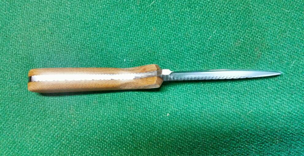

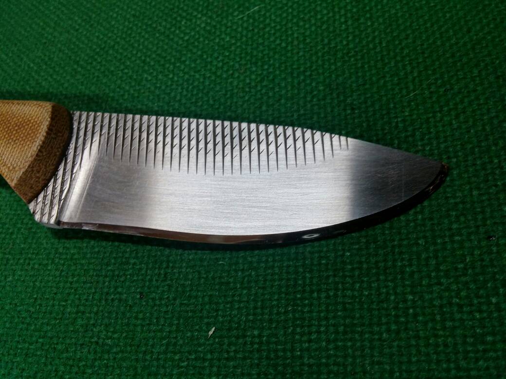

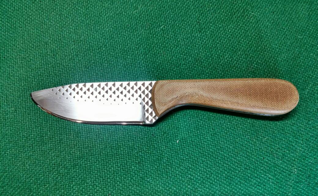

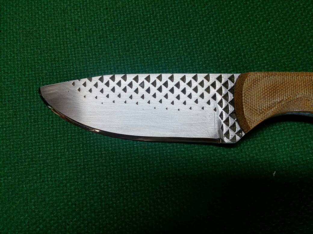

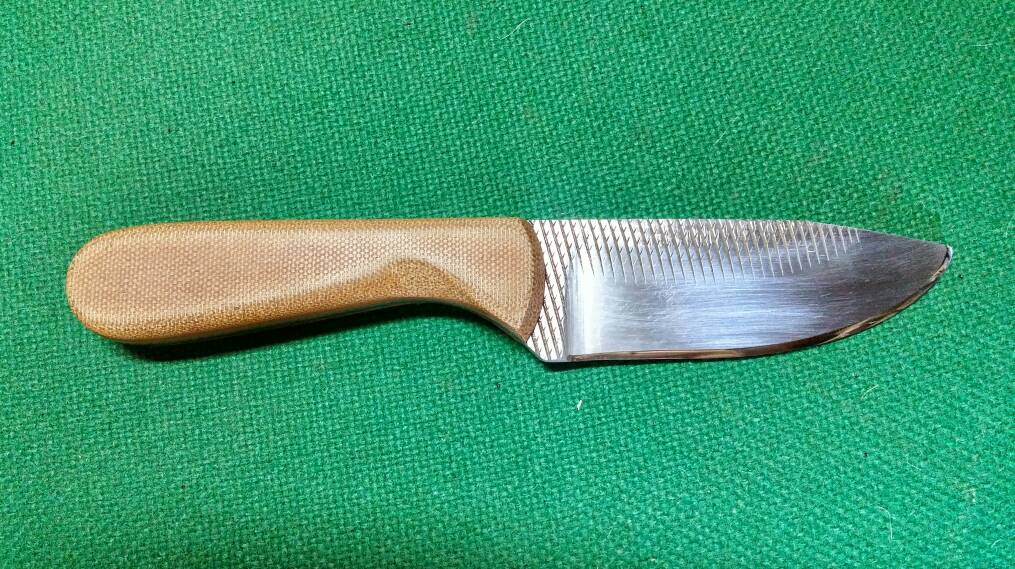

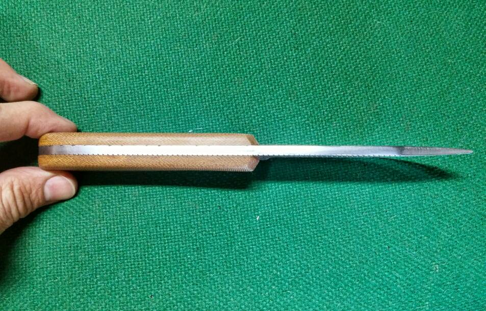

A farrier buddy of mine gave me a pile of rasps to play with. I went to the grinder and this is what developed....these things are HARD and it was slow going.
I finished to 400 grit and threw some canvas micarta scales on. I'm going to make a sheath this weekend....im ready to take this one to the woods.

Nice! I love the look of file/rasp knives and the pattern that shows.
