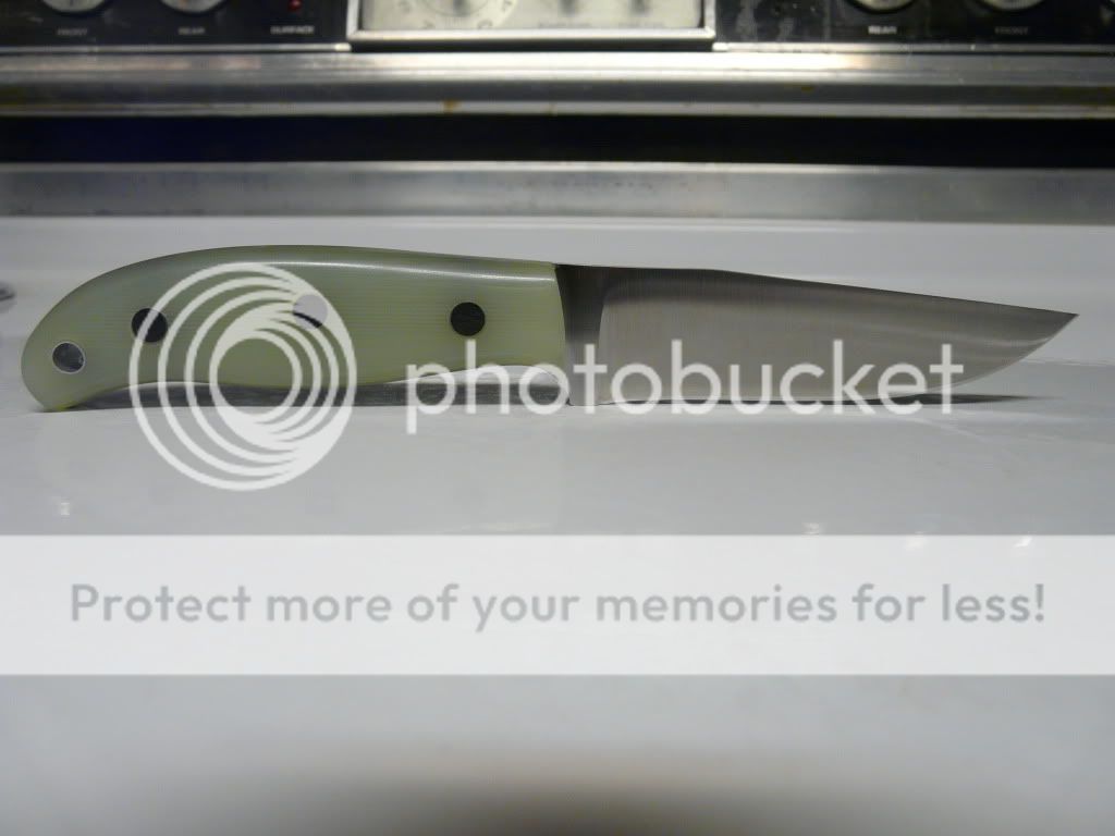

Drop point utility, Jade Green, AEB-L Razor Steel
Feedback: +20 / =0 / -0
Oct 3, 2010
219
Here is another one utility or kitchen or both. I am trying to get people on board with AEB-L, some day?
Price $130 shipped within the U.S.
Kydex Pocket sheath available upon request
Full Tang
Handle- 4.0"
Blade- 4.15", edge 3.9"
Drop point shape, full flat grind spine to edge ground
Handle material- Jade Green G10 chamfered edges , G-Flex epoxy with 1/4" Black Linen Micarta pins and 1/4" aluminum lanyard tube.
blade Steel AEB-L razor steel, Stainless composition like 13c26
Blade Finish is belt finish
Edge is V- grind on cardboard wheel system then hand stropped to remove bur and polish edge
Heat Treat in House, plate quench, sub zero freeze, 2 2HR temper cycles, Tested at 62 RC
Nice knife! I've got a puukko from seved hjelm in AEBL and its one of my favorite users. people will catch on to it.
That looks like an awesome blade. I love the design as well as the choice of materials and the fit/finish. Great job and I'm glad Doubledee got it so I wouldn't have to worry about spending Christmas money on it!! ;)
