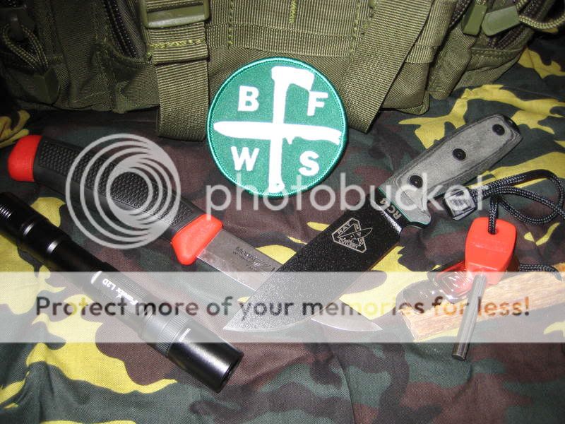

The knife with the orange... Is that a Bahco? If it is I got one recently as a beater knock around knife that I can play with. So far I am impressed. Not as good as RAT of course but not bad for $6 I think. How do you like yours?
It's actually a carbon steel Mora Clipper and it's as sharp as a razor :thumbup:
Marthinus
Is that the fs104 from County Comm? Does it work well for you?
Yes that firesteel is the FS104 from countycomm and it works great.

AAAH. You have carbon! I have stainless :( They look exactly the same! I must admit. I am surprised at what a great slicer the grind is. It is a Scandinavian grind or am i wrong?
Carbon steel Moras are typically made of 1095 steel hardened to 59-60RC and given a scandi grind.
They are razor sharp because the grind leaves a zero degree edge and the steel is HT'd a little harder than average for 1095. Great slicers and cutters, but with little lateral strength or overall flexibility. The carbon ones do kick ass over their stainless counterparts though.
