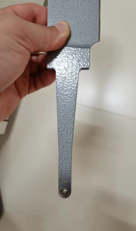

DT-12 Res-C handle cutaway pictures. Why it is hollow?
Jul 13, 2023
304
Someone sent me some cutaway photos of a DT-12.
It appears that the tapered tang does not fill up the handle.
Is it for shock damping?

Thanks, another photo for my tang shape database.

This is my first time seeing this post. That tang on the dt12 is disappointing to say the least. Big step backward from the days of the camp tramp and that 1311.

Is it really that big of an issue? I have Nepalese Khukuris with the traditional "rat tail" tang construction that is demonstrably thinner than what's seen in the DT-12 and, despite beating them into hardwoods for years, I have yet to break one. I have likewise beaten on my DT-12 and haven't yet shaken it loose.
Hasn't the DT-12 been around for a few years? If the tang construction was a major issue, wouldn't we have seen someone posting pics of their broken knife by now?

I see your concern being that the tang is not as wide or robust looking.
However, they did it on purpose, removing more material raises cost, it would not be done if there is no benefit.
(Some manufacturers would weld on rat tangs to the blade, so they could cut much shorter blanks thus reduce the cost of material, which is not the case on the intergral blanks of DT-12 )
Tapered tangs like such are not only more than strong enough, they offer a number of benefits like shock damping\high chopping power at given total weight etc.
You may have a look at Joe X’s testing on DT-12 and the tang is very durable.(Though I have criticised many aspects of his review, but the video footage are still raw data with some value. He is rather biased, but he can’t alter the laws of physics)

It's not necessarily the tang breaking that has me concerned. Jerry is good about still having all the corner radiuses, etc, to avoid stress points. I have sent back knives for handle replacements before because the resiprene loosens up. This design will make it more likely as the back end is only supported by the tube rivet.

I don't believe for a second that these handles are shaped by hand on a grinder. The form is CNC cut. I appreciate the total faith in Jerry only making manufacturing decisions for our benefit.
Don't get me wrong, I believe the knife is still a beast. I just have opinions on this particular change and I would have more confidence with the beefier tang of the past.
That is a good point. I wonder if it would make sense to punch out the tube rivet, pull off the resiprene handle, fill the lower part with epoxy, then press the handle back over the tang in order to fill the voids. Although, at that point I reckon you might as well just install a new handle and pommel.

I did not mean that the tang is hand shaped.
I meant that there is no motivation to do the tapered tang except for better chopping etc. , it certainly is not going to lower the cost, machining or material wise.
I have not had res-c loosening on me, after throwing them or hitting the pommel with wood baton.
If you have had res-c loosening on you, I agree that it is a reasonable concern about the hollow.
Yet I think in general res-c are solid and you might be seeing some flukes.
Have the replacements loosened in use?
If not, then it’s probably not a common problem.

I’d say that it’s a deliberate tapering tang for better balance and vibration control.
I see no other motivation for doing so, it’s not going to be cheaper to produce.
They made an accidental mistake? Unlikely.
