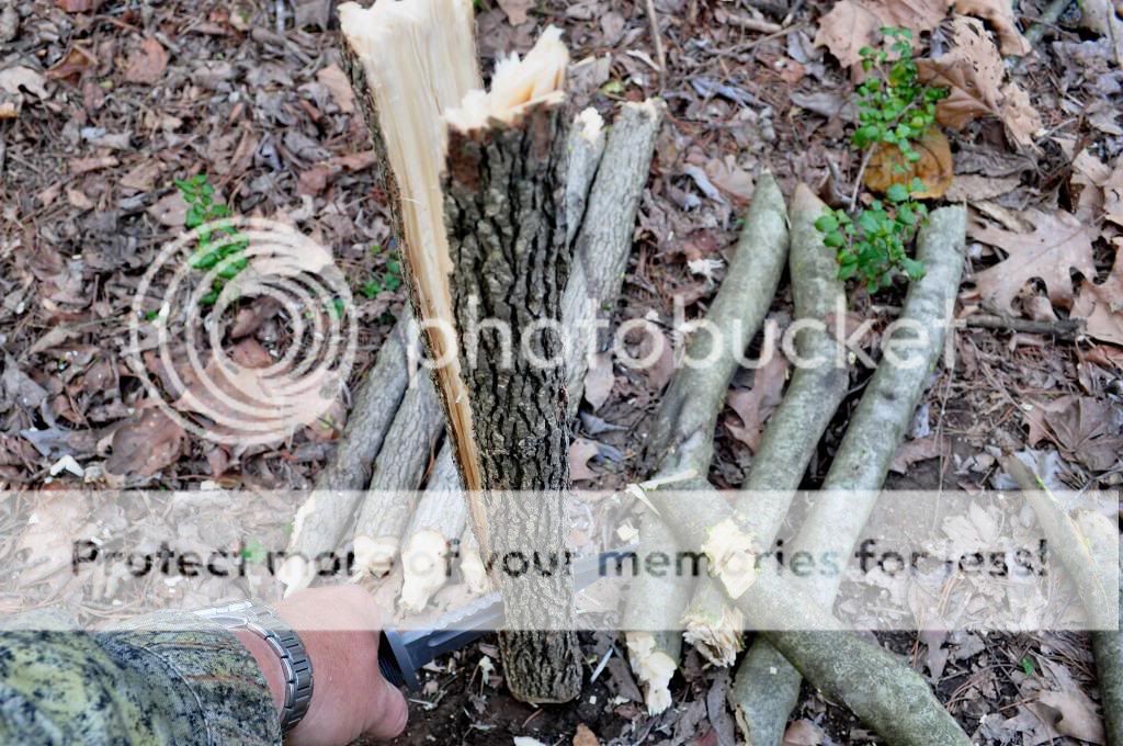

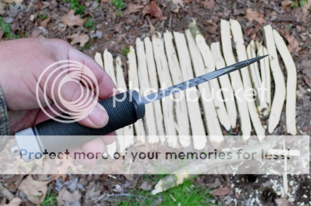

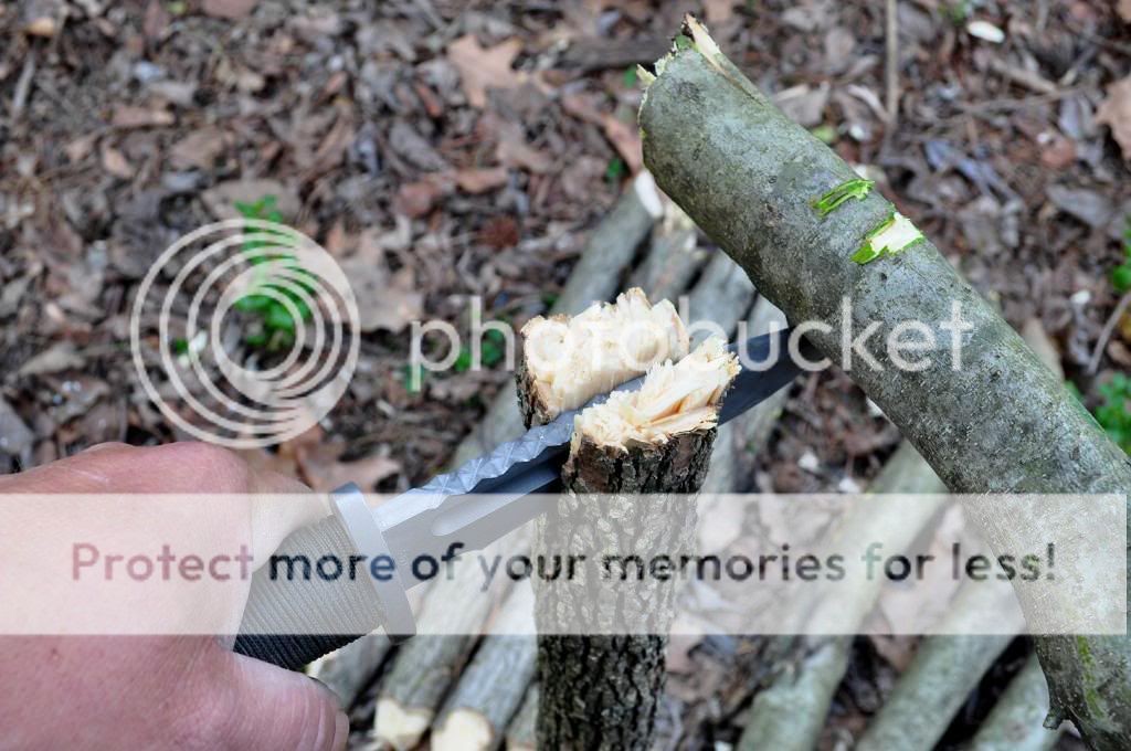

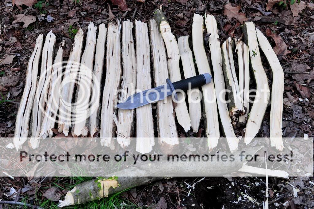

These images suck because photobucket and I parted ways in 2019 when new owners went nuts with hosting membership prices, and Newt Martin's Caiman I was reviewing is definitely not a bushcraft knife with the sharpened swedge, but you can see the knife and the baton both survived quite a bit of batonning. With the Forager I'd just try to strike the hump where there is more steel in the blade, not the tip
