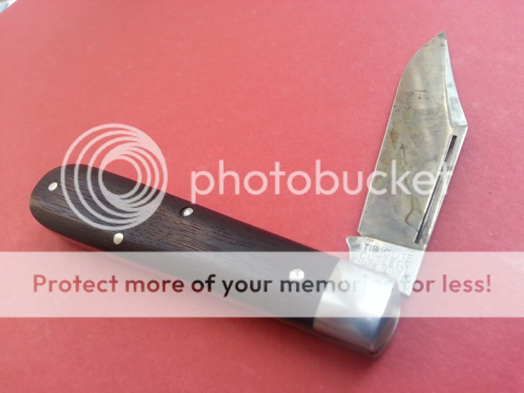

Wondering if someone can advise on which is more durable in terms of daily use - Ebony or Cocobolo? I mean as far as getting it wet occasionally (water in food prep or gutting a deer for example). Also which is tougher as far as overall dings and dents in heavy use?
Can't say I've used both long term but my ebony boy's knife ended up in the dishwasher and it came out in pretty good shape.

I have to say ebony would be my choice both in opinion and scientifically. Ebony is harder and therefore tighter grained and more durable. want more proof? check out the 100+ year old knives in ebony with barely any blade left but perfectly smooth black ebony handles.

Anyway, those are my personal observations. However, both cocobolo and ebony are so much more durable than woods like oak, maple, hickory, etc, that you really only need to pick which one you like better. I have century-old antique slipjoints with cocobolo and ebony, some of which obviously saw plenty of use with little left of the sharpened-down blades, and the wood has held up just fine.

As far as appearance of well-used cocobolo is concerned, most cocobolo will darken significantly with age and use. In fact, many of the pictures that I see posted in this forum of antique slipjoints that are labeled as ebony are actually probably cocobolo, I can see a hint of red. I have some cocobolo handled knives that were beautiful grained and medium red when new, but are now almost black. If you hold it in direct sunlight you can tell it is cocobolo (reddish cast, which you never see in ebony).
