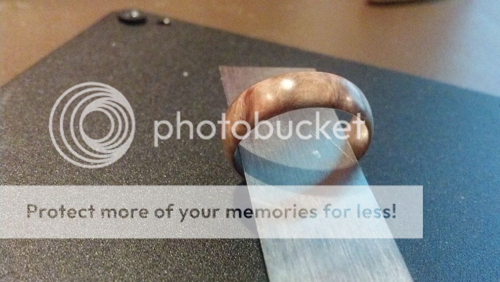

I made some stabilized burl wood rings in the past, and coated them with CA type glues.
It can get super shiny when buffed, but after a few weeks it starts to wear off. The good news, is that you can simply pick it off, and re-coat it. Lather, rinse, repeat as often as you like.
