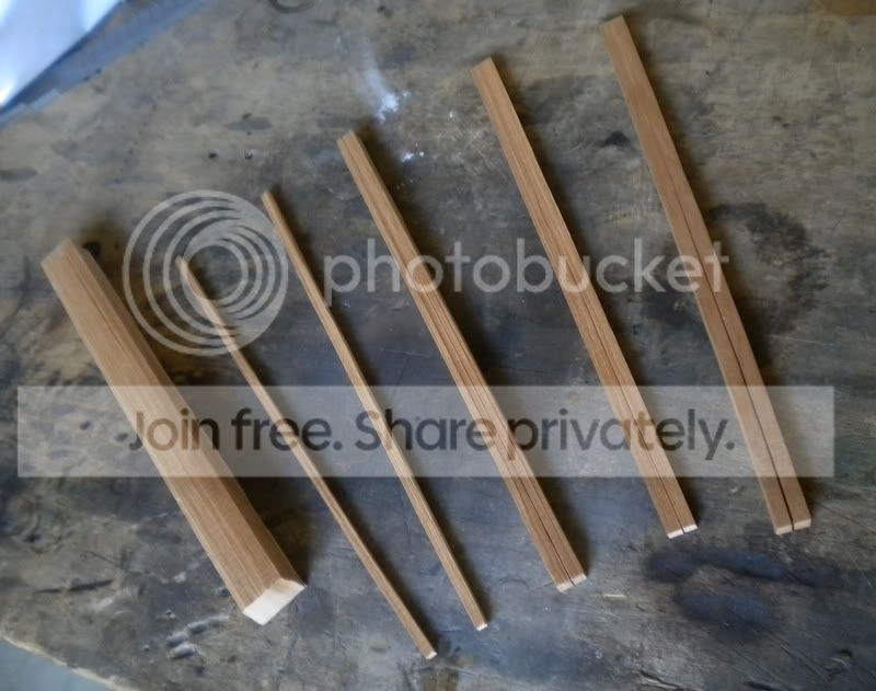

Good points Nathan... but don't rule out chopping 1/4 inch balsa. ;)
Or better yet,... rive out (split lengthwise) a perfect pair of cedar chopsticks and still tree top a hair?
I bet I could do maybe even 4 pair, but the stakes would be mighty high. :)
I'd probably go with Don's W2 and canola.
Something like this. :)
