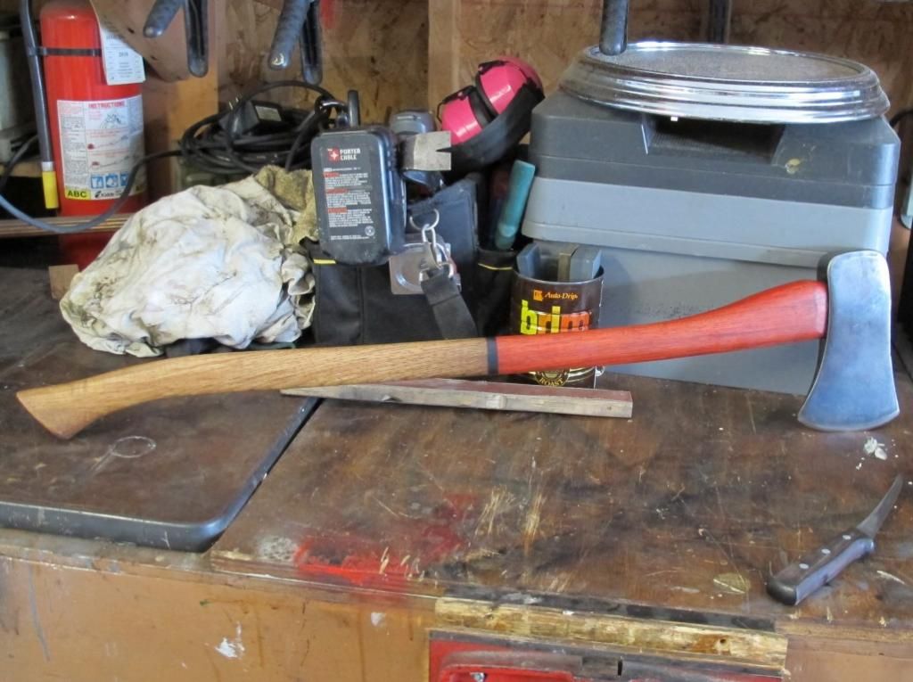

Dye/coloring for axe handles. What are you guys using?

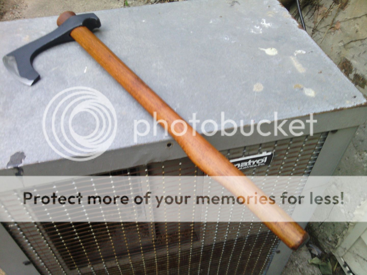

On the one I actually used stain on I used an alcohol based stain I use on guitars, it does not raise the grain like water based stains and dries in just minutes.
http://www.stewmac.com/Materials_and_Supplies/Finishing_Supplies/ColorTone_Liquid_Stains.html
I love StewMac's stuff. Have you tried mixing the color concentrate with Miniwax Tung Oil? That's a very nice handle, BTW.
I have not mixed it but i have used it in tandem with oil stains. I did this 40x stock with a very light coat of red, really just a pink hue, and then an oil walnut stain, followed buy 30+ coats of hand rubbed lacquer.
That is an awesome axe. Thanks for the link, I went Google hunting the last time you showed that axe and mentioned the alcohol aniline dyes, did not find them. Any idea how UV stable the colors are?

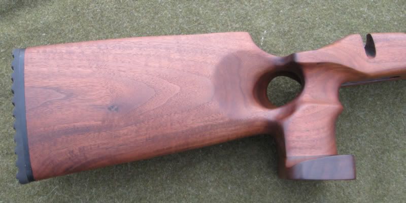

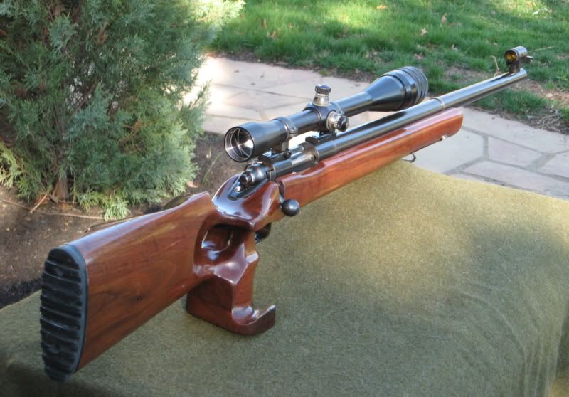

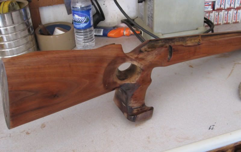

Laurel Mountain Forge stains are alcohol based and don't fade much if at all, just another option. I raise the grain and darken wood with a vinegar and iron mixture, rubbed on with green scrub pad, then apply stain for color.
This is maple, but it works on hickory also,

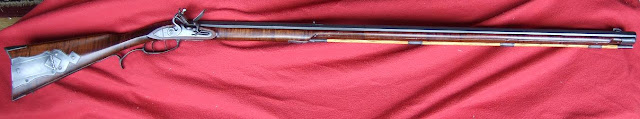

Interesting looking smoke pole. Is this an original or a re-creation and do you use it? Drop at the heel on a lot of oldies does take some getting used to.
I built it based on a SW VA original with some reckless license. The stock was precarved/uninlet but heavily modified, and the mounts were made by me. I shoot it 1-3x month in offhand matches, woodswalks, etc. The drop is good for me, as I shoot off my outer shoulder/upper arm.
It was several years ago, my first flintlock, first try at making the mounts, etc., so I didn't get everything perfect, but I still like it.

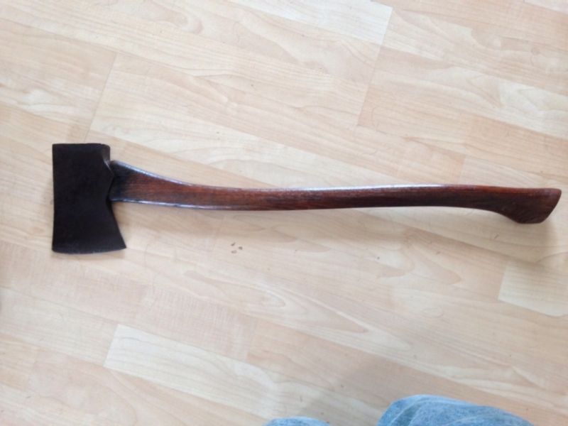

I typically just use 3 in one oil, brings out a LOT in a handle. That snow and nealley I just bought took a few coats but the handle looks gorgeous now and the oil even brought out the snow and nealley stamp on the handle.
Figured. Looks damn good now that you're some with it! How's it hold an edge?
I have used it to fell a small tree split some wood for my fire pit and have had to only touch up the edge. Aqua Fortis has to be heated to work then a few coats of BLO and a couple of coats of gun stock wax. Never saw a haft treated with 3 in one oil does it not make it slippery ?
Not too bad, havn't ntoiced much difference between that and BLO of course this handle was about as dry as as a stick could get. Five coats and it seems to be back to where it should be! Turned the wood a beautiful dark color, pictures up after I'm done buggering around with that DB head that was used as a prybar.
