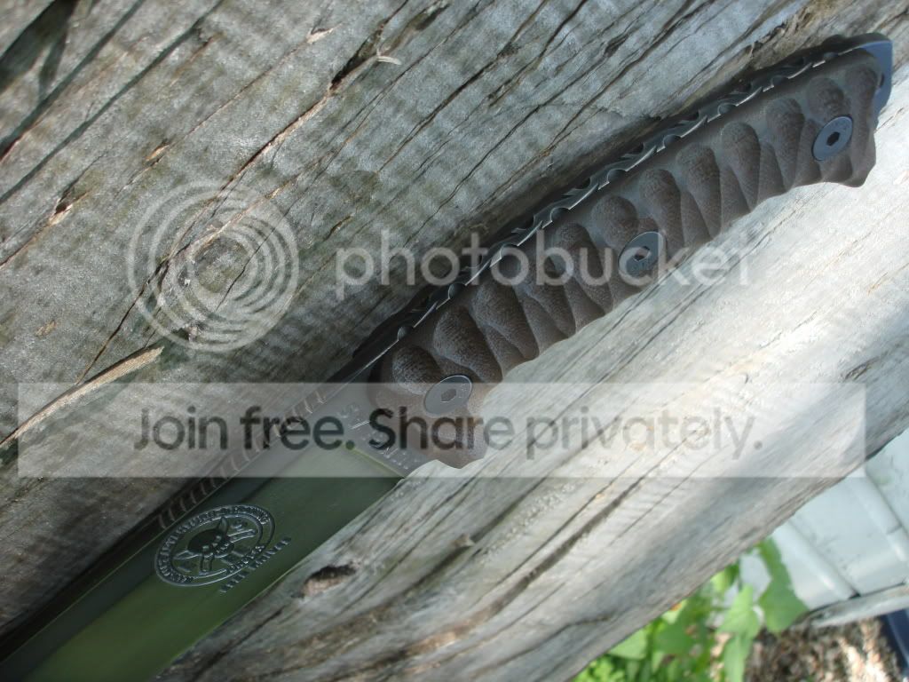

I'm modding the factory micarta scales on a knife by reshaping them a bit, and dying them a darker color. I used Fiebings leather dye, and though it looks pretty good, the color transfers off onto my hand and rubbing cloth no matter how much rubbing and buffing I do with the cloth.
I've used up half a dozen cloths rubbing and buffing these things over the course of three days and still get color transfer! So I'm wondering if there is some kind of sealant that is safe for use on micarta that will stop the bleeding color??
I have some beezwax already, but I'm not sure if it is safe to use on micarta or not? Or if it would even help?
Anyone have experience with this?

oops.. Sounds like I should of researched more before I started this project! I wonder what effect the beezwax stuff I have would have on my dyed handles?
Fiebings leather dye has a sealer you need to buy, and apply after the dye to stop color transfer. I have some but cannot find it to get the name right now.

They are production scales. I'm modding an ESEE Junglas. It came with very light tan, (almost white) scales.
Just snapped a few pics of it after my dye job....
....I'm not looking forward to it, but I guess I'm going to have to strip most of the color back off. :grumpy:
One nice thing about Micarta is it does NOT absorb things. I would not try and seal anything in. Only going to come off with use. Maybe the boiling technique would work for the outter most surface??
Right. That's pretty much the whole point of using micarta or G10 for handles - they're tough and are affected very little if at all by moisture, most chemicals, etc.
