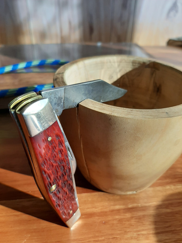

The shield side turned out nice and actually has a lot of depth in person. It's also brighter than the picture makes it look:
The pale side is still lighter than the shield side but it is not nearly as obvious as before:

I think that is a great improvement! I will admit to not being a fan of Case Amber Bone at all, I like the darker colors on my knives, especially dark red and dark brown. OH

The mark side turned out great!!:thumbsup: The pile side is OK, but could maybe use a couple more applications??;) Nice knife either way!!
Hi Charlie. I put numerous coats on that side, to include straight dye. It got to the point that I don't think it was soaking it up any more and most buff off.
So I stopped there. But this is the reason I think the bleaching approach would likely be better. Start out more even to get more even results.
