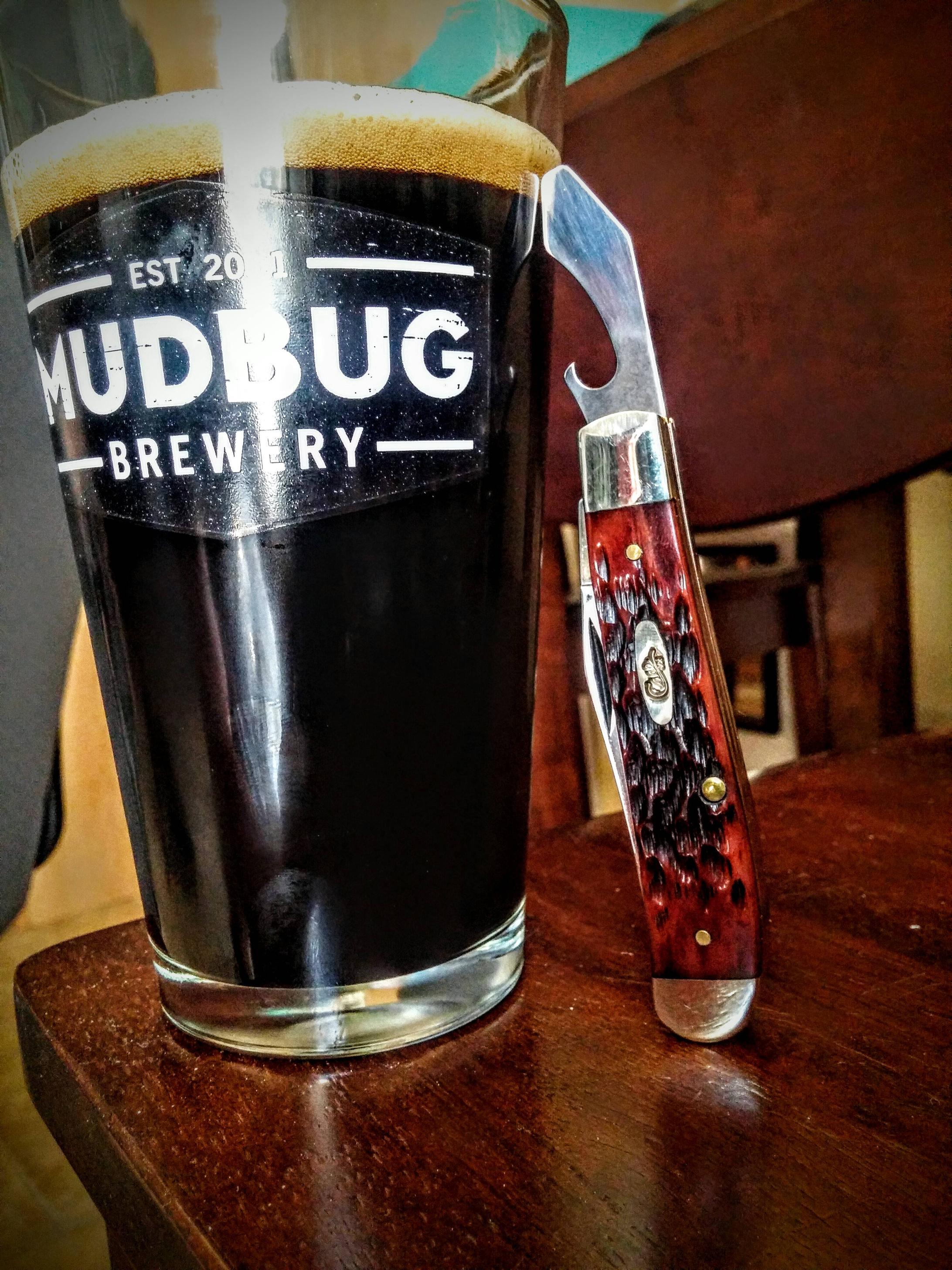

@Ratbert I used a combination of Cherry Red and Brown RIT dye on my Jigged Amber Bone Case Beer Trapper. It took close to an hour simmering on the stove to get to the final color desired, but it came out fantastic!
Maybe Case uses denser bone than GEC sources? I’ve heard that camel bone supposedly takes a long time to absorb dye. Have we seen pics of your Case? I’ll have to look back at the posts...or would you mind posting again here?
