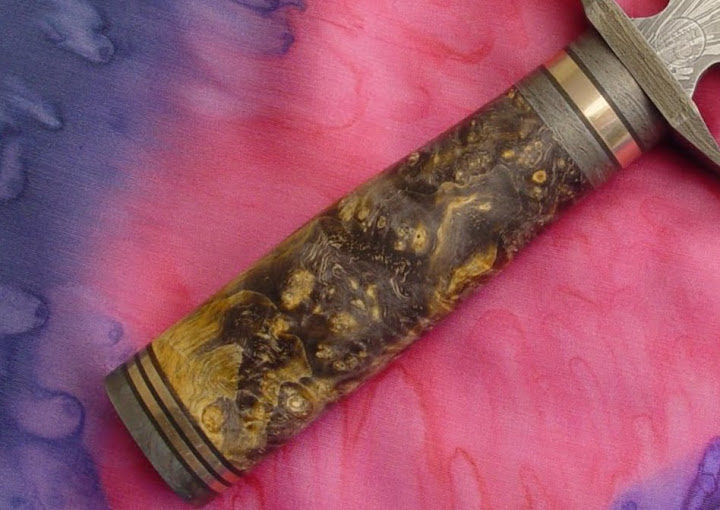

Bigleaf maple burl in green and blue. Much better color & contrast in hand
Edit; I kept resizing this pic 'cause it was HUGE, now ya can hardly see it! :confused::o
- maybe just delete......

I got some double dyed box elder from Mike Ludeman several years ago (some gold/black, some brown/black I think) that was awesome, most of the people who saw the knives I put it on thought it was some kind of stone.

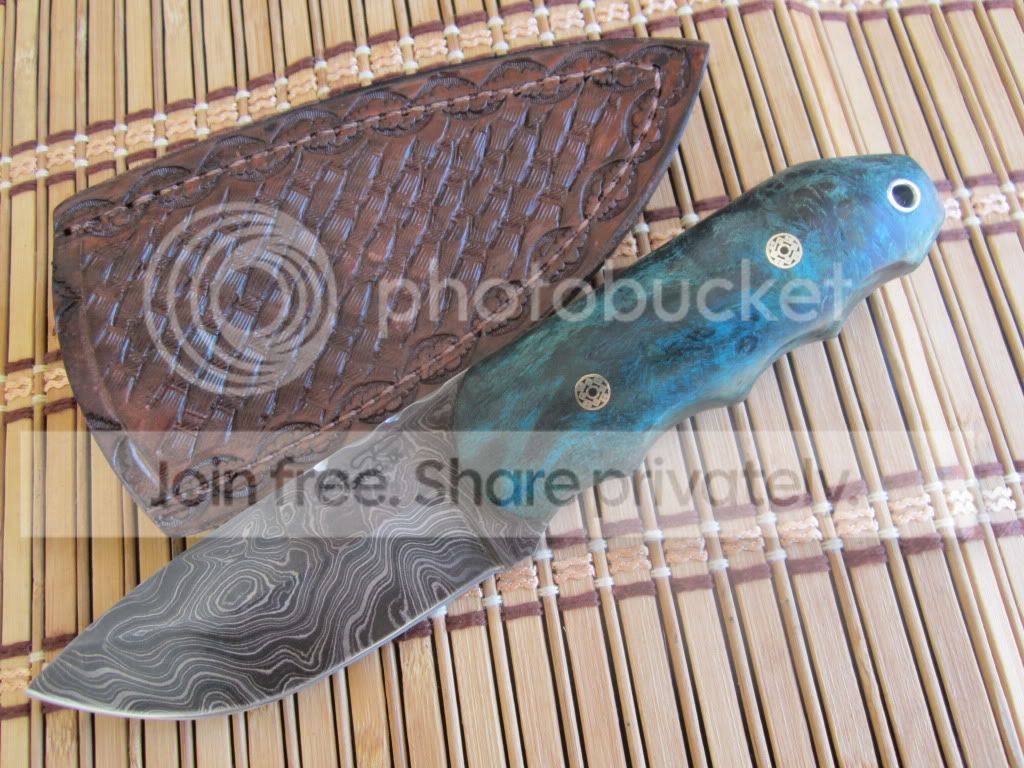

At first I wasn't going to dye any burl blue but a few people asked for it.
I went ahead and asked K&G to dye some dark blue all the time knowing it wouldn't look good.
Shows what I know.
This is a knife with Dark Blue Maple Burl that Claudio made and is putting in the mail for me.
I feel like a kid at Christmas time waiting for it to arrive.
