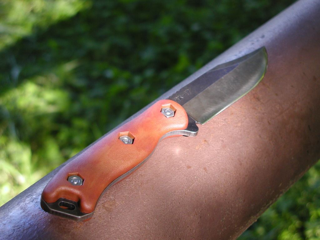

they turned out awesome, i love the color. Im going to have to grab some rit for mine.

Scuff it with a gray 3m automotive paint prep scotch brite and paint them tan. That is my next day project.
It looks like you can stain it a shade as evident by some of the pics but nothing drastic. I wanted orange scales so I roughed up the grivory and hit with Rustoleum. Holding up OK thus far.

Yea they look great! I hope mine will turn out close to that. you think if i just used dark green it would be ok?
yea im gunna grab some from amazon and see how they turn out. thats the good thing with the tweeners you got 2 sets of scales so experimenting with one is no biggie!
I used dark brown RIT dye on my peanut butter scales.
