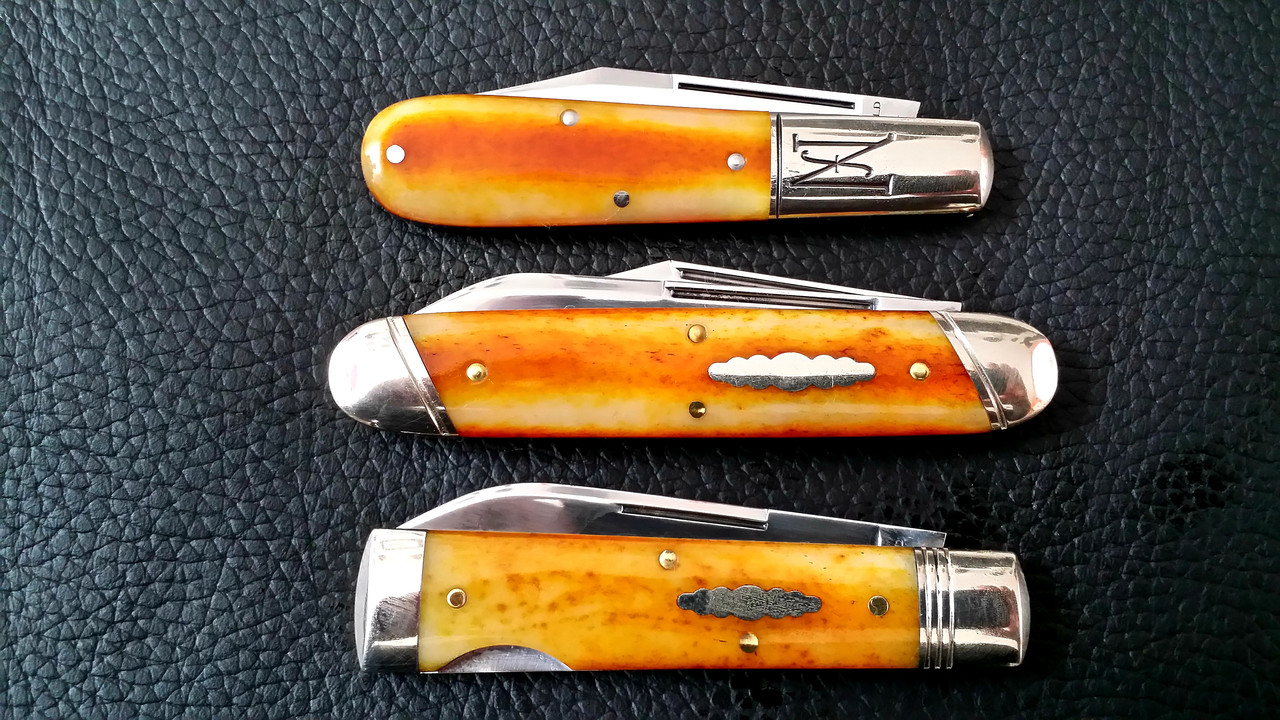

I did these 2 ages ago...the black was a disgraceful grey ...like a dead cats face...yuk...so it went in the black rit ...much nicer.
The lge stocky was a brown too similar to another one so it went in the cherry red rit...both used the powder dye in a pan of hot water...there was minor staining on the CV blades of the big one...nothing to worry about really..

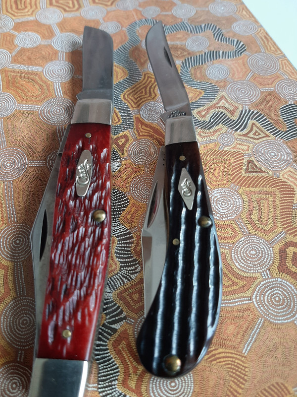

As Mark (Ramrodmb) indicates, masking is the key to keeping the blade, bolsters, and springs free of staining. Before masking, I put a very light coat of mineral oil on the metal surfaces (wiping off excess with dry towel) to help repel the dye (as extra protection along with the masking). Take you time doing the masking and trim the tape w/ razor blade for clean edges. After masking, wipe down covers with alcohol wipes to make sure no oil is on them. I used RIT and hot water (nothing else) which works fine on bone (as others have indicated). This Beer Scout was Golden Ale before being immersed in a hot bath of dark green with a touch of black. Full confession, I've not tried Micarta. Micarta is indeed impregnated with resin BUT Micarta does absorb moisture to some degree, generally the coarser the parent material, the more absorbent the Micarta.

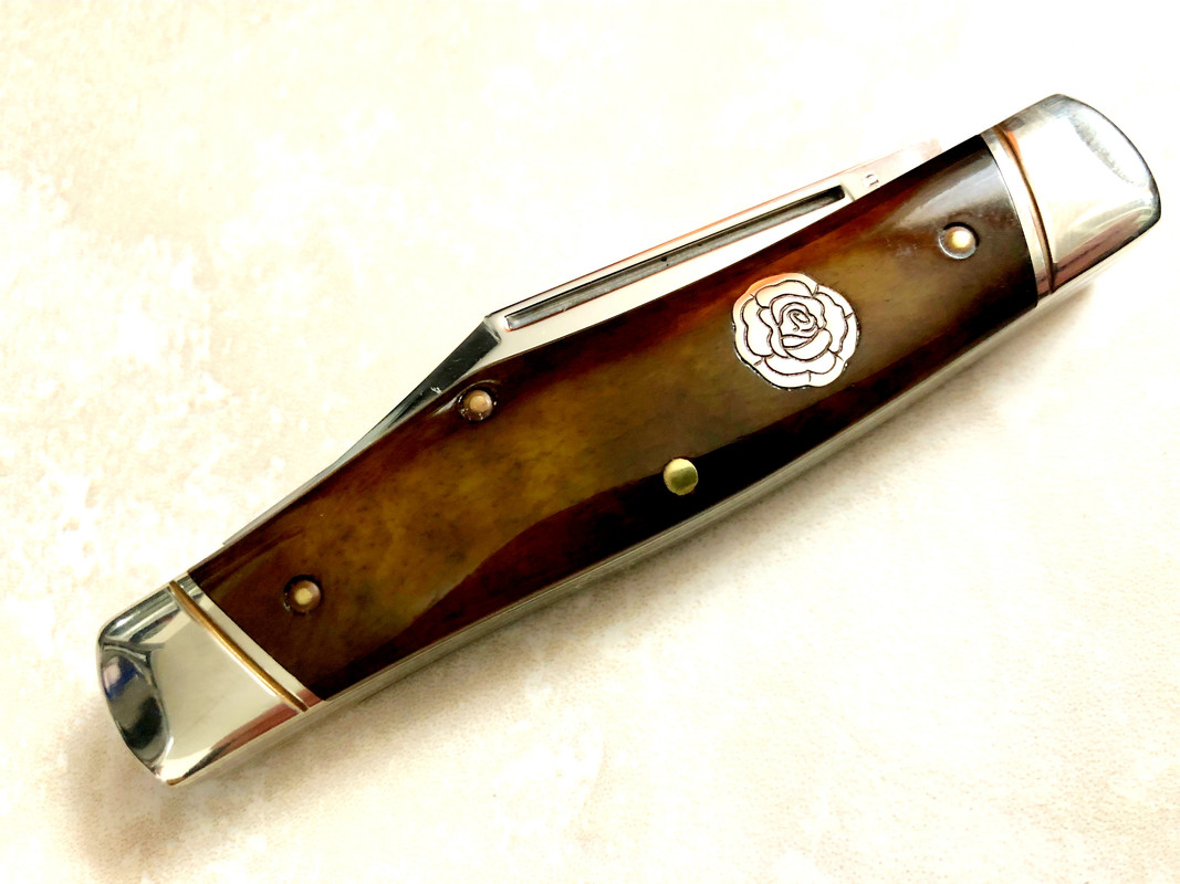

I did the fiebing's dye job. I am absolutely thrilled with the results!
