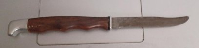

I know it is not a great picture. I'm sitting here on the sofa playing with my phone to learn how to take a picture and transfer it to my laptop. Having succeeded, I might as well post it. The knife. 4" X 9/16" blade, 8-1/2" OAL with a LV handle which is unfortunately badly cracked (worse on the other side). I would classify it as a 102 and tentatively place it about 1951. The unique interesting feature is a very slender longer than normal handle and a minimal guard profile. I have big hands which makes It a really sweet knife proportionally to hold. I wish it wasn't such a mess.

LV is almost guaranteed to crack, lots of Makers won't even touch the stuff....
One of my edc blades I scaled up with it. Yes, I get weird crosshatch cracks.
I found filling with thin super glue, then gently sanding clean (after it dries) works very well.
But only recommend working on non historical pieces

Hi Craig, thanks for the comments. This is an early pre-factory era hand made Buck knife. Historically collectable so not a user.
LV was used about '51-'55 and I understand was discontinued due to cracking. Late 50's saw the switch to Ebony.
The picture does not show but there is some warped displacement, not a simple crack.
It's more a question of stabilzation for preservation in my mind.

Does Buck have a restoration program for Older blades?
I bet they would get a kick out a seeing the oldies.
If nothing else was available, I would use a thin viscosity crazy glue. Maybe only wick it into the cracks, not fill completely, keeping the cracks from spreading, but still holding the history of said cracks.
