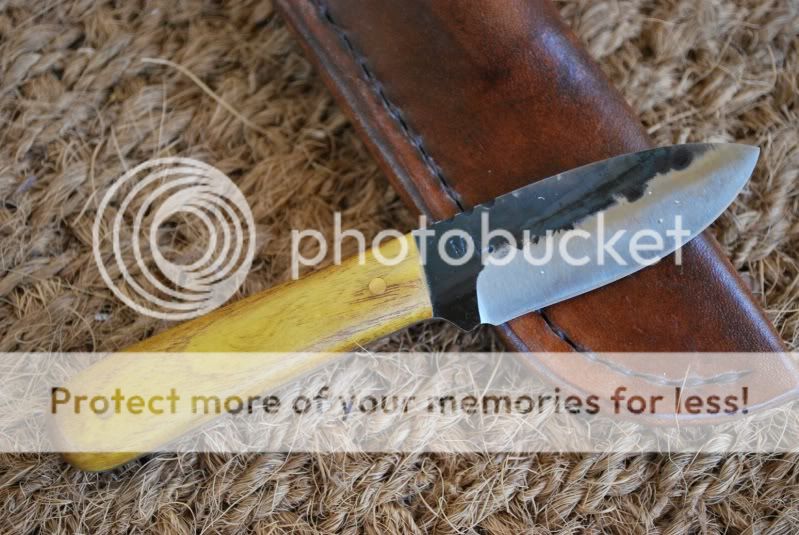

Quirt, I have a green river Hunter pattern... it;s a real deal classic knife though this one has custom maple handles.. it;s a great looking thin slicing machine... I'll happily give it to you if you pay shipping... as I don;t use it much....email me at bushbum75@yahoo.com
Here's a pic

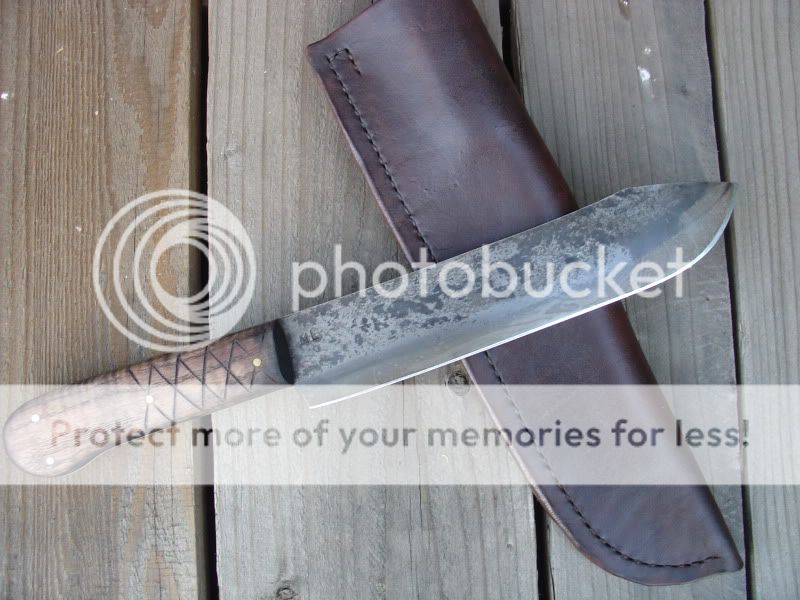

check out Matt's work from ML knives.. his stuff is amazing and is almost all period/rustic looking.. www.mlknives.com
i just pulled the trigger and ordered one of these..:D
