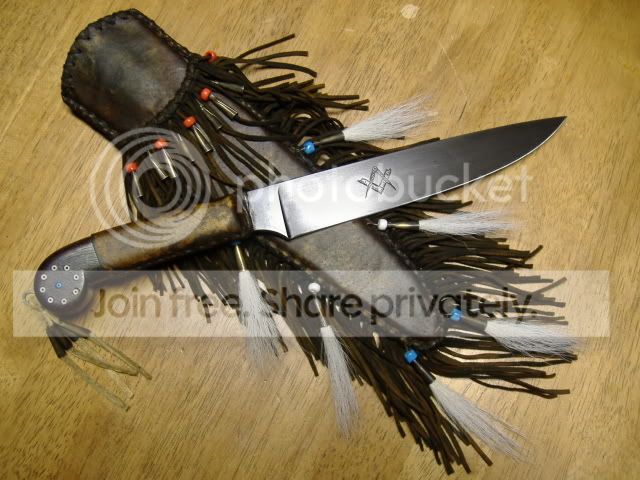

Just finished this one today. 8" 01 steel partial tang blade with acid etched Masonic emblem. Walnut grip wrapped and sewn with deer rawhide. Forged iron loop on butt with deer braintan tassels and brass cones. Deer rawhide wrapped sheath, deer hair brass cones, and a few trade beads. All lightly aged. This outfit was bit time consuming. Thanks for looking.
Wow ! That knife is really sweet LRB :thumbup: I think you've got the frontier style sheath down pat too ;) Very, very nice package :thumbup: :thumbup: :thumbup:
I can see, with all of the details, how that could become quite "time consuming". I would say it's been worth every minute :) :D

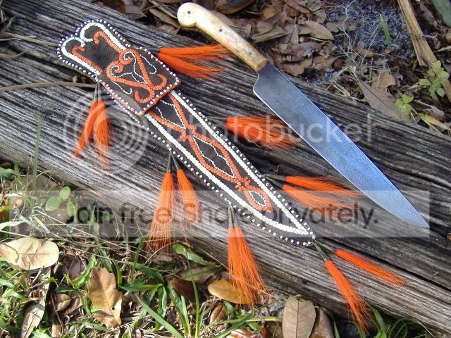

Would bone handles be appropriate on a knife of that era and that particular design?
Most definately would. Flattened cow horn scales would be also. This one is a partial tang, ending about where the rawhide ends, so to keep thing easy, I use wood on these. Here is a ball grip with bone, but this is a very tapered full tang. The sheath is by Dan Reese.
