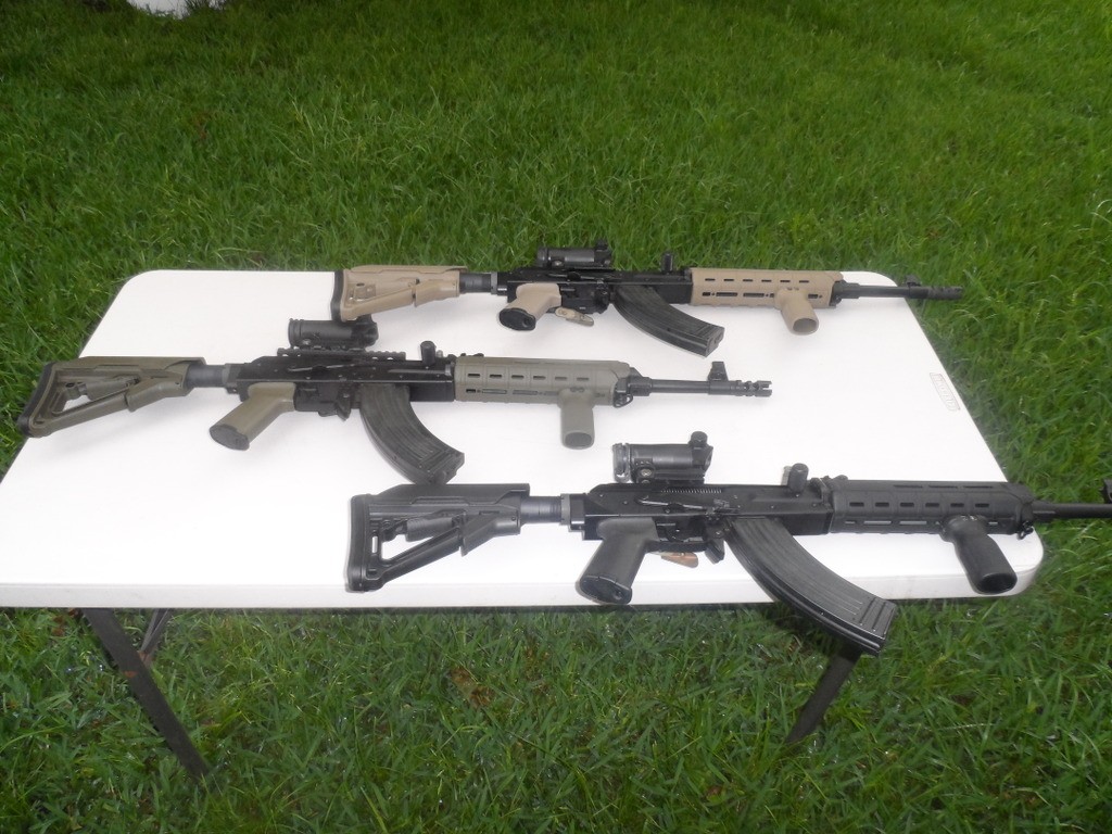

always been more of an AK guy myself....
3x VEPR 7.62x39s...pick a color, any color...

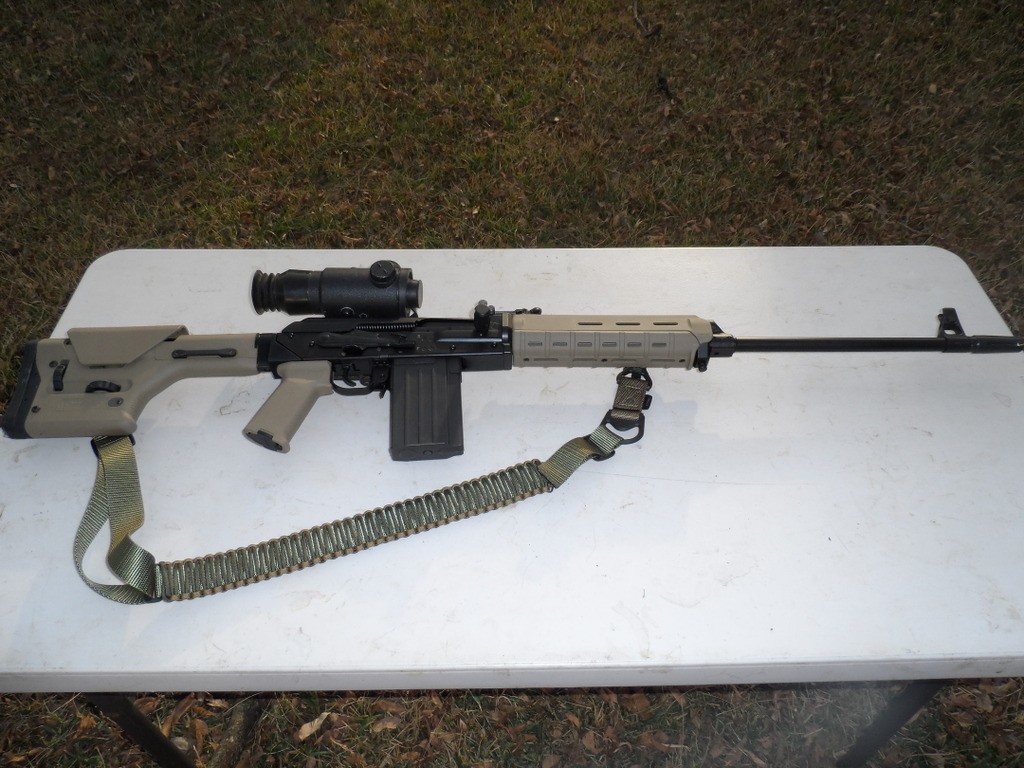

VEPR 308

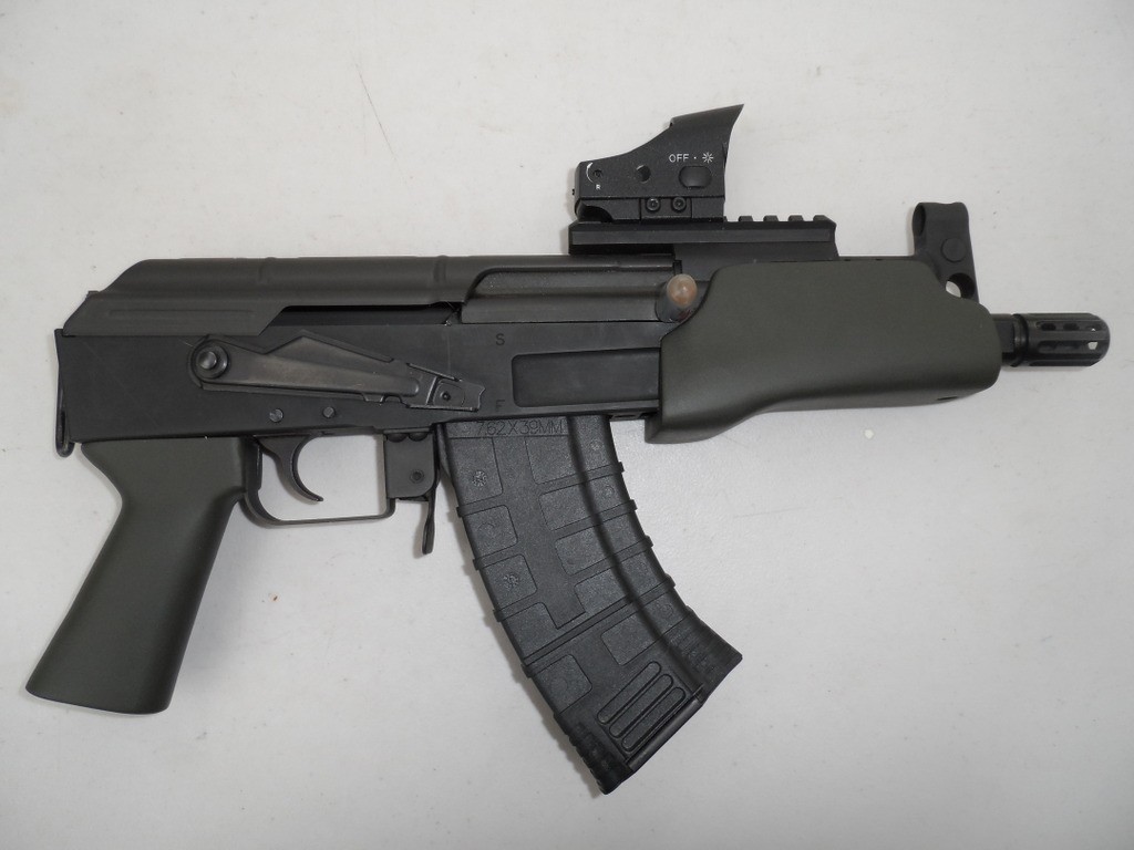

Shorty for use as my current " truck gun " .....7.62x39
I have just over 20 AK varients....I really like the stupid simplicity of the design.
Impressive ak builds.
Any functional and accuracy improvements with these?
I always had the impression AK work best As designsd

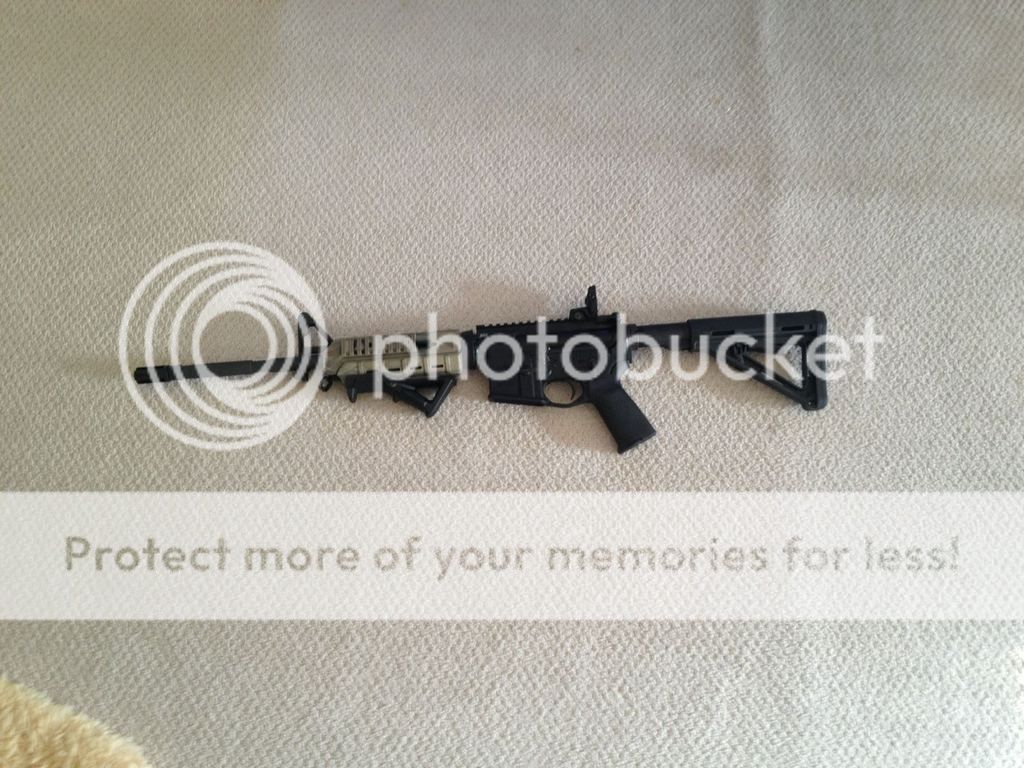

Mine's pretty standard, but I like it. Yankee Hill Machine lower receiver, Palmetto State Armory upper with a 16 inch M4 profile barrel with M4 feed ramps. The lower is their standard MOE lower parts kit that I assembled myself. Now that I think about it, I'm not sure I ever loc-tited the castle nut for the buffer tube.
Furniture is all Magpul, MOE stock, MOE grip, MOE handguard, and MBUS rear sight. Flash suppressor is an AAC Blackout without the quick disconnect for sound suppressors. I bought the handguard from someone else, and who had painted it. It's a sort of diamond pattern of tans. He sold it to me with two rails with low-profile ladder covers. I also have as you can see the Magpul angled foregrip. I like it, though I am considering trying out one of the smaller versions.
I would peen or steak your buffer tube castle nut instead of using Loctite. There should be recesses on the back side to peen the back plate to the castle nut. Nice set up, they don't need to have all the bells and whistles. Just good quality components.
It does have the recesses. I just didn't have a good way of doing it when I put it together. My brother now has a wrench for it, so I'll have to borrow his.
