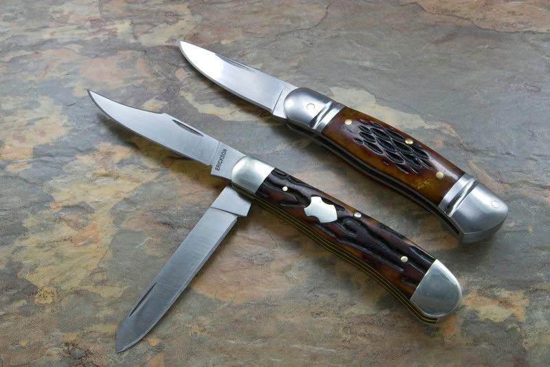

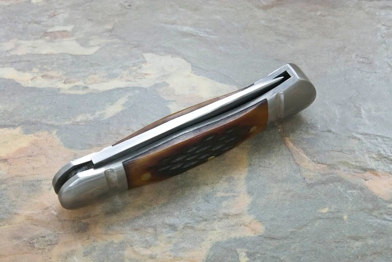

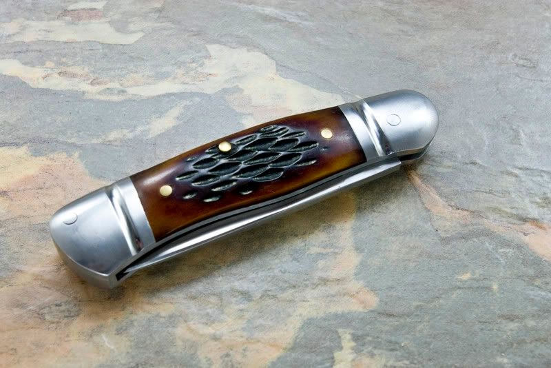

Here is a picture of my first slip. Lets see, what did I do right on this one------------------------------what did I do wrong, pins show bad, not flush in any position:eek: blade hits back spring,blade grind way to thick, etc. But I learned a lot from this first one. This one is about 3 5/8 O1 blade and spring,416 one piece surface ground bolsters and frame. Yes , surface ground, yikes, before I had a mill. It took all day just do do the grinding.

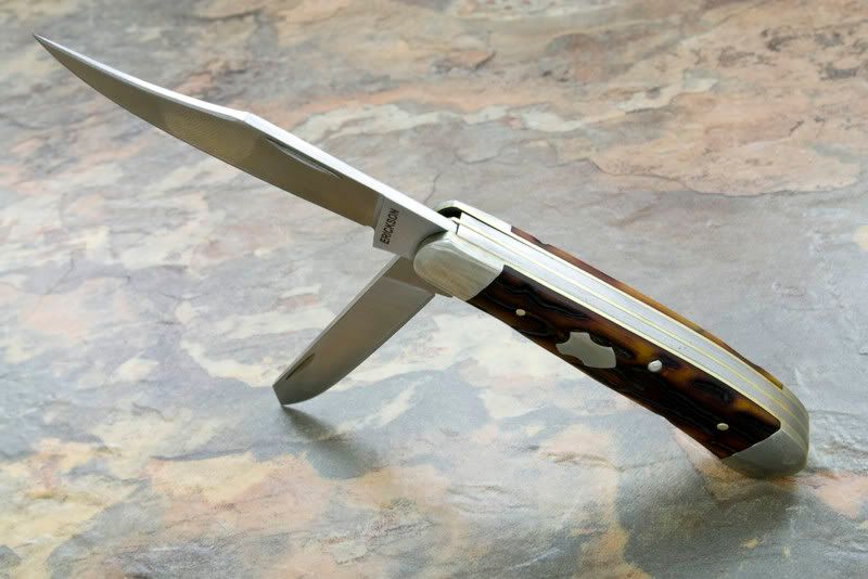

The trapper is also 3 5/8. My first multi-blade slip. This was also one of only about 6 slipjoints that are made with brass liners and soldered nickle silver bolsters. The biggest fault with the trapper is the walk and talk are a crawl and whisper! LOL
Anyways , thanks Elliott for starting the thread. Its a kick for me to share my progression as a maker of slipjoints.

Ken they look pretty good for first-es. I really like the pattern of the first single blade you made. You should replicate it. With your knowledge and skill today I think it would be a unique pattern for you.
Elliott's knife is a winner also the pattern looks to be a stout knife which I like...
