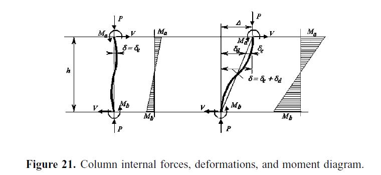

You probably are misunderstanding the surface area that I am speaking of. It's the surface of the TANG that I want more engagement to, regardless of the geometry of the lockbar.
First, yes,. Depending on who the maker is, you are going to see varying geometries as well as contact point widths. Some have more engagement than others. The the pic the OP posted for example. Do you think that the lockbar itself will never slip in this position? If so, is it the faith that you have in the bend/spring force on the tang that gives you such faith? If this is the faith that you have,..what do you think about applying a force perpendicular to the axis of the blade, either intentional or unintentional? Something like a spine whack, or even batoning? Probably won't even take this much force depending on the pivot, the thickness of the ti and a few other factors. This is saying absolutely nothing about material fatigue or improper heat treats of the lockbar face.
And one last question; Ever wonder why Chris Reeve and a whole host of others target having the center of the tang as the optimum spot for the lockbar? If the center was causing them issues, either with returns or failures, do you think that they would have moved the position to a lower percentage of lockup?

1. I do not think that the lock will never move. I have spent a bit of my free time studying tribology, enough to know that any liner/framelock cycled enough times will move to a higher lockup percentage. That movement rate may be imperceptibly slow, and it may change over time. This is evidenced by people having locks move from 30%-60%, and then "stopping" there.
2. Increased surface area contact could reduce pressure on the lock/tang face. This could reduce the possibility of plastic deformation of the lock face. From everything I have seen, the lock fails due to buckling rather than face deformation. If you have any examples/anecdotes pointing to the opposite, I would truly be interested in seeing them.
3. A framelock can be thought of as an end loaded column. Force applied to the ends of the column can lead to buckling. Further offset of the contact point from the bending point will require greater internal moments to counteract the load, and thus increased likelihood of buckling failure under the same load conditions. Here is an image that describes this.
4. Here's the interesting part...I think the difference would be negligible in any real scenario. I'm not trying to say that less lockup percentage is better. I'm trying to say that MORE lockup percentage is NOT better. I don't think it matters very much at all, as the movement is relatively slight and failure loading is normally high enough that I think both lockups would probably fail under the same real-world shock load. If someone has done enough testing on identical lock interfaces to show a strong correlation between lockup percentage and failure load with a high level of statistical confidence, I will gladly be open to their results. I would love to test it myself, but I don't exactly have the resources right now :o
