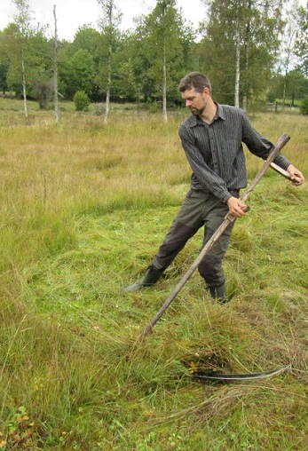

The Slavic snath is the simplest, in the form of a straight, single-gripped snath. The left hand is held in an underhand hold at the top of the snath, not too unlike sweeping with a broom. This style works and is easy to make, but does make it harder to put the muscles of the left arm to work, which is why the other three methods all represent an attempt to bring the left hand lower where the muscles can be better engaged.

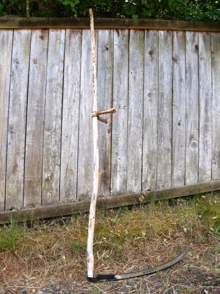

The Nordic snath describes a straight line from the blade through the right hand, with the shaft of the snath passing over the bicep and a stem extending for the left hand. There are a number of different snath styles present in the Nordic nations, but this variety is one of the most geographically distinct.
