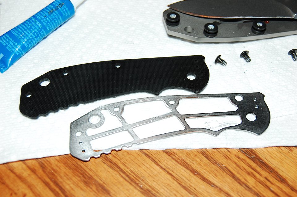

Hi brboru7 -
Some of the knives were sent out with the G10-side stainless steel liner having not been tumbled to polish them, and as a result some of the liners had minor discoloration / rust on the surface of the liner.
To put the problem into perspective, here is a picture of the rust on my example:
And here is what the same liner looked like after 2 minutes of polishing with #1000 sandpaper:

Thanks for the very informative photos.
I suspect that most people, upon discovering those spots on their new, $200 knife would not consider it a minor discoloration.
My reaction would be more like, "Yikes!"
Nor would I want to take the chance that elbow grease and sandpaper might be able to keep that rust at bay for the life of the knife.
Sending those early 551s back for warranty service benefits not only the present owners but anyone who might later buy those knives on the forums here or elsewhere.
