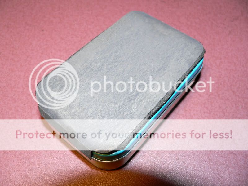

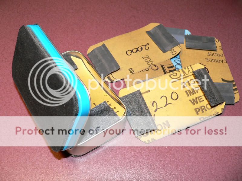

Here is a field kit I was using for a while for convex blades.
Mouse pad on Altoids tin with sandpaper of different grits inside. Strop on the other side. Compact and light kit. There also some room left inside for the other small stuff.
Best thing about it, is that I don't have to concentrate on the sharpening job. No need for special setup, just hold the tin in one hand and sharpen the knife with the other hand. I can do it while sitting by the campfire and relaxing at the end of the day. Using 220 grit I can repair the damage, if I need to, and other grits all the way up to 3000 and stop to polish the edge (and grind) and make it razor sharp. Cheap and effective.
