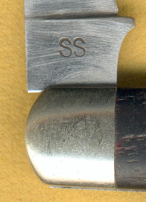

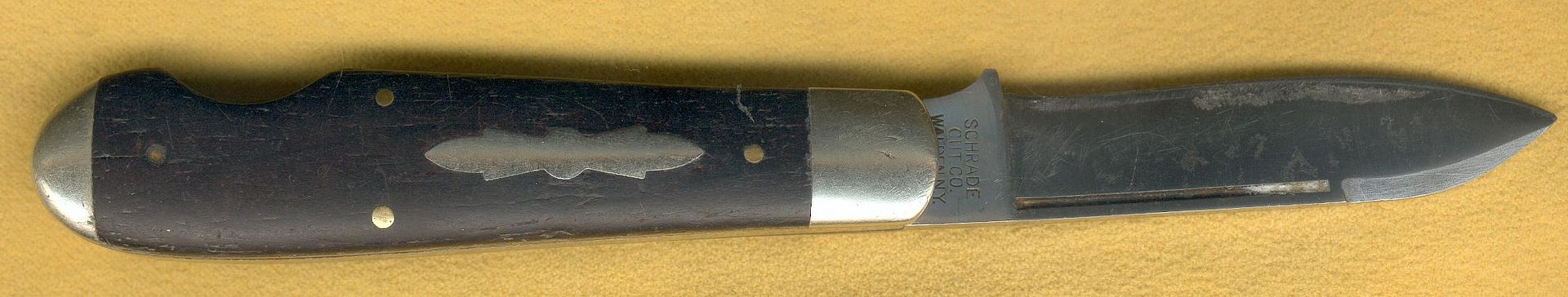

He asked me to look at this Easy Open Jack, and tell him if I could, if it was original. Here are pictures;
I have a reproduction Schrade Cut Co. catalog that covers 1926 to 1936, and another that covers 1940. A limited sample, for sure.
All EO Teardrop Jacks in the catalog, not just the stainless ones, have two blades, the secondary being a pen blade. I've never seen a single bladed EO Teardrop Schrade of this size, 3 5/8". There is no stainless knife with Ebony handles listed in either catalog! Ebony was cheaper material, and they were trying to get people interested in stainless. It failed back then (1920s) and Schrade dropped stainless for a while I believe.
At first glance, it appears all the parts are Schrade, and I still believe that is true. But it is a very hard knife to judge, using pictures!!
So I asked my friend to send it to me.
It's the subtle details that gave it away. Most of those details are slight; a few thousandths of an inch!!

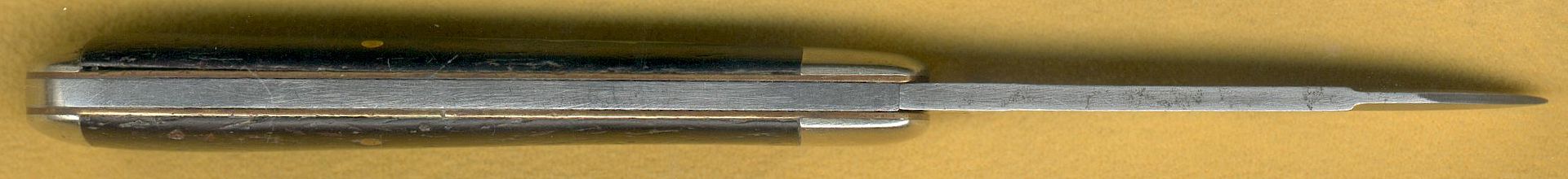

The backspring rides high when the knife is closed and at halfstop. When a cutler in a factory hafted a knife, the backspring was always sanded flush. You can barely see the backspring in the third picture down.
The backspring rides low when the knife is open. The blade sits higher than the spring when it is open, and is slightly thinner than the spring.

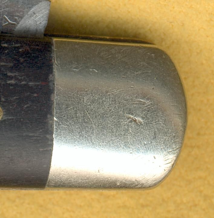

The Main blade pivot rivet has flaws in the "head"; missing chips.
As a beginner, I might have missed ALL these subtle signs. Now that I've gawked at thousands of Schrades, I can tell with a fair amount of certainty that this knife is put together from parts.
One of the best questions you can ask yourself, when you are looking at a vintage knife is, "Would a good cutlery let this knife out the door?"!
The pen blade and accompanying spring were removed, as was the main blade, and a Stainless blade was swapped into the knife.
The knife is quite usable, but does not represent a legit sample of Schrade's production.
I am sorry I can't provide you with larger pictures, and only hope my descriptions succeed in communicating the details.

Check out the pivot rivet though, it appears that those are just dents in the bolster. I'm pretty certain the rivets are aligned closer to the handles on those teardrops. Judging by the location of that spring end, the location of those dents would put the rivet too close to the edge of the tang. Pretty decent repair if that's what it was meant to be, but you're sure right about it not being a production model.

My first thoughts on looking at the pics (prior to reading the text) were:
No knife company in the old days ever made a single blade teardrop EO jack...two blades, yes, single blades, no.
Schrade made a number of stainless pocket knives circa 1920's to 1930's in bone and celluloid but none in ebony and stainless.
Then looking at the pic, the main backspring pin is not tarnished like the handle pins indicating that it may be of newer vintage, consistent with a knife that was taken apart and rebuilt.

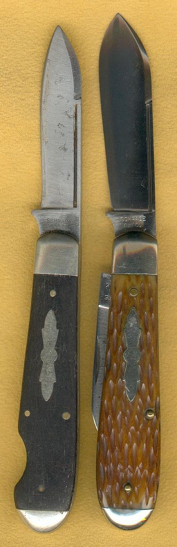

I think the blade is from the same pattern but in stainless. And it is indeed short, causing it to "peek" (peek out of the handle - cute term:)) It also "peeks" because it doesn't quite fit.
Here's a near mint blade next to the subject knife. The handle pattern is the same, but without the EO notch. A lot of blade has been used up, as you can see.
Eric, the rivet and hole are where those chips are. I tried several times to get the chips on the pivot to show, but couldn't quite manage it. Aging scanner. The pits you see in the main bolster are partly those chips, which are caused from improper peening technique. The hole is damaged and not round, and the edge of the peened cap is ragged.

Dang! Maybe I need some glasses after all :eek:, I can't see a whole lot of damage. We are talking about this pin, right? Maybe the scanner's losing the detail:
[/IMG]
I agree with Eric, the pin to me looks invisible. It does not look to have been re-pinned, on either end of the bolsters. I have never seen a single blade E.O. like this as has been mentioned, but I have seen people cut their own E.O. notch in an old knife, if you look at this knife that is most likely what was done to it.
