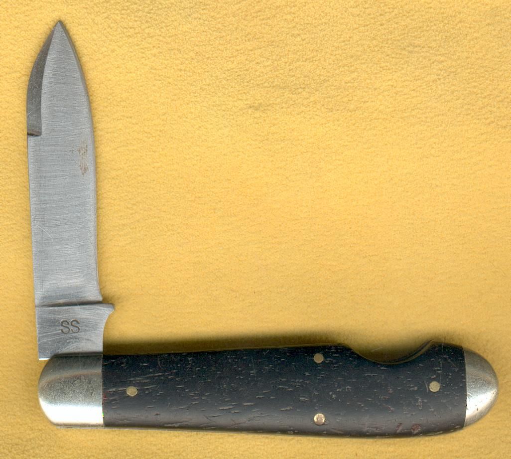

Eric and CE, it's good to have you guys keeping me on my toes.
I read the rivet further out where the dings were. I rubbed a little compound on that spot, and the ghostly circle line disappeared, and of course I now see the real rivet. All I can say is Duh, and thanks!
The rest of the evidence stands, IMO. The EO notch matches the other EOs I have very well, making it unlikely it was cut after-market.
When or why this knife reached its current state is just conjecture I think.
It could have been made during lunch hour many many years ago. It could be a repair or salvage effort a bit more recently. Maybe it's a "test" knife, for Schrade to try out its stainless blades??!! Only one in existence!!! Worth thousands!!
It's humorous, but I have a recent Case trapper with a CM-154 blade in it, assembled for testing by Case's associated knifemaker! It is one of a handful made!
It's not likely to be so poorly fitted though, if that were the case.
I lean toward a salvage operation, either repairing a broken-bladed knife, or using up Schrade parts. I've added pics of the pile side for further clarity.
WN, how do the scratches on the tangs match up with the scratches on the inside of the liner?? This is usually a good sign the blade has been in that frame for some time.
CE
CE, the rubbed spots alongside the kick have rubbed paths into the liners, and the spot where the kick strikes the spring is quite pronounced. I'd say the blade has been there a long time.
Charlie i'm not clear on your final conclusions. sounds like you are agreeing that pivot pin looks original and that it could be "a salvage operation, either repairing a broken-bladed knife,".
Wouldn't repairing a broken bladed knife mean replacing the pivot pin ?
So therefore, if done in house by a Schrade cutler the replaced pivot pin would look just perfect ?
roland
The pivot pin looks better than I thought, Roland. That does not mean it is original.
In my limited experience, I have re-pinned a couple of knives, where you cannot see the pin. I learned how to do it from a Stan Shaw video!!
I conclude that the original blades were removed, and only the main blade was replaced with a stainless one a long time ago. The handles/scales, which look as originally assembled, and early, could be 80 years old!
Each handle scale, including liner, bolsters, handle material (ebony in this case), and shield is assembled and often semi-finished, before the knife is finally assembled with springs and blades.
It's hard to say when the post-production work occurred. If the stainless blade was new, then it's a high miler - used a lot! But it could have been in the 1920s! Or . . . . .
judging from the wear patterns up into the 1950s-1960s!! Purely guesswork.

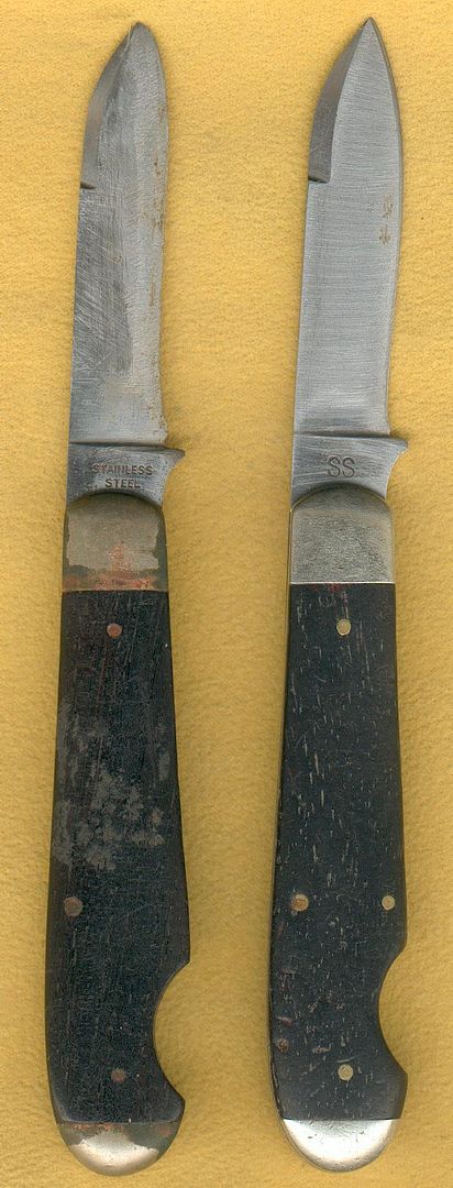

Let's not assume that if you can't find a knife in a catalog that it was not a "regular production" knife. This one has been sitting in a junk drawer in my "PILE" for many years. I didn't think much of it until I saw this thread. I always thought it was a shame that someone took a grinder to sharpen this, it was a nice knife at one time. Here's the pix:
Woah! VERY interesting! Looks like paternal twins!:D
Casts a new light!

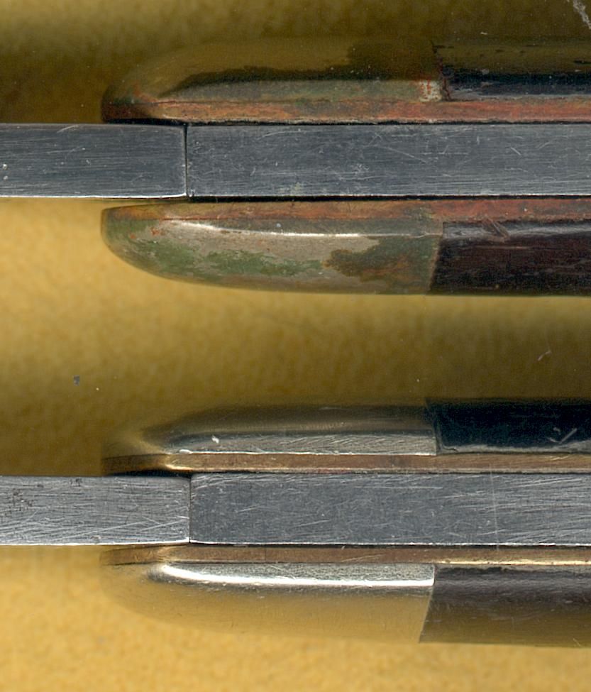

What is the fit like, Barry?? The blade and spring appear to be the same thickness.
Is the rust on the inner tang surface a transfer from the spring?
First one I've seen with that stainless steel marking. The only ones I've seen to date have SS on the back tang.
The Blade and back spring are the same thickness. The spring sits a half a hair lower than the blade in the open and closed positions probably from wear. This knife was not taken care of by the original owner, probably never oiled and probably ground early in its user life. If I hold the knife to my forehead & close my eyes I can hear the the original owners voice say " YEE-HAH look at them sparks". The crud on the inside tang is only surface dirt that flakes off with a toothpick. There is not any rust on the blade or spring, I'm guessing they are both stainless. The inside of the knife is dirty yet the stainless back spring is shiny on the out side. I would say, this knife has never been apart since it left the factory. The blade has slight side to side wobble in the open position. Barry

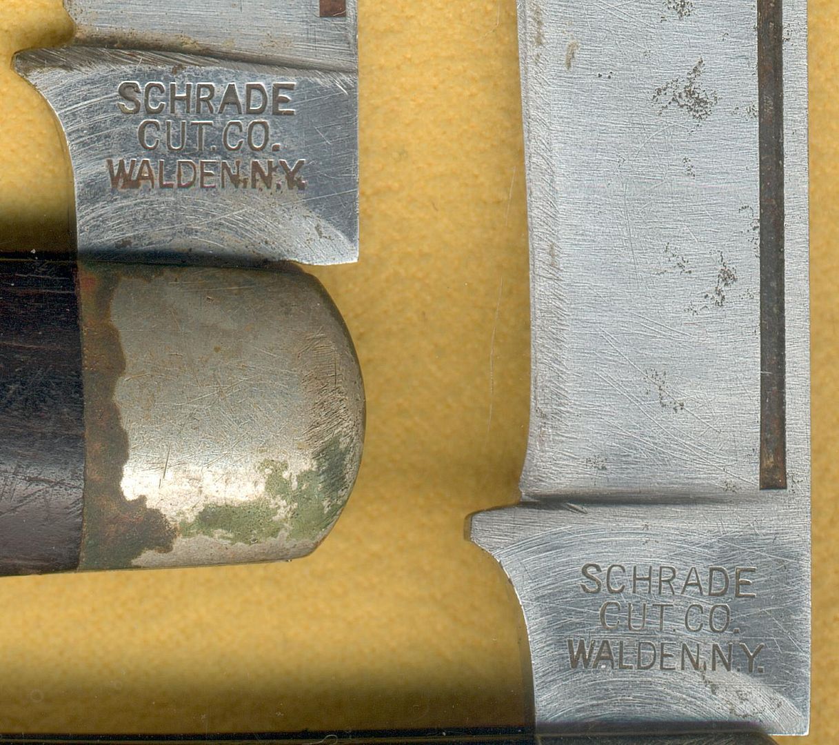

Barry sent me his knife to do a side-by-side comparison, and I managed to pick it up and scan it today with Roland's.
Barry's knife has some corrosion on the bolsters, and so is easy to tell from Roland's. The ebony is very dense on both knives, some areas almost looking synthetic. The density probably is responsible for the relative good condition, despite signs of being in adverse conditions.
Please take a good look, and comment as you wish!

Roland`s knife has one extra scale pin, and the e.o. notch is a little further forward than Barry`s knife. Otherwise they look very similar.
CE
The main thing I see is the width of the blades. Barry's appears to be the same width as the spring. Roland's is narrower.
