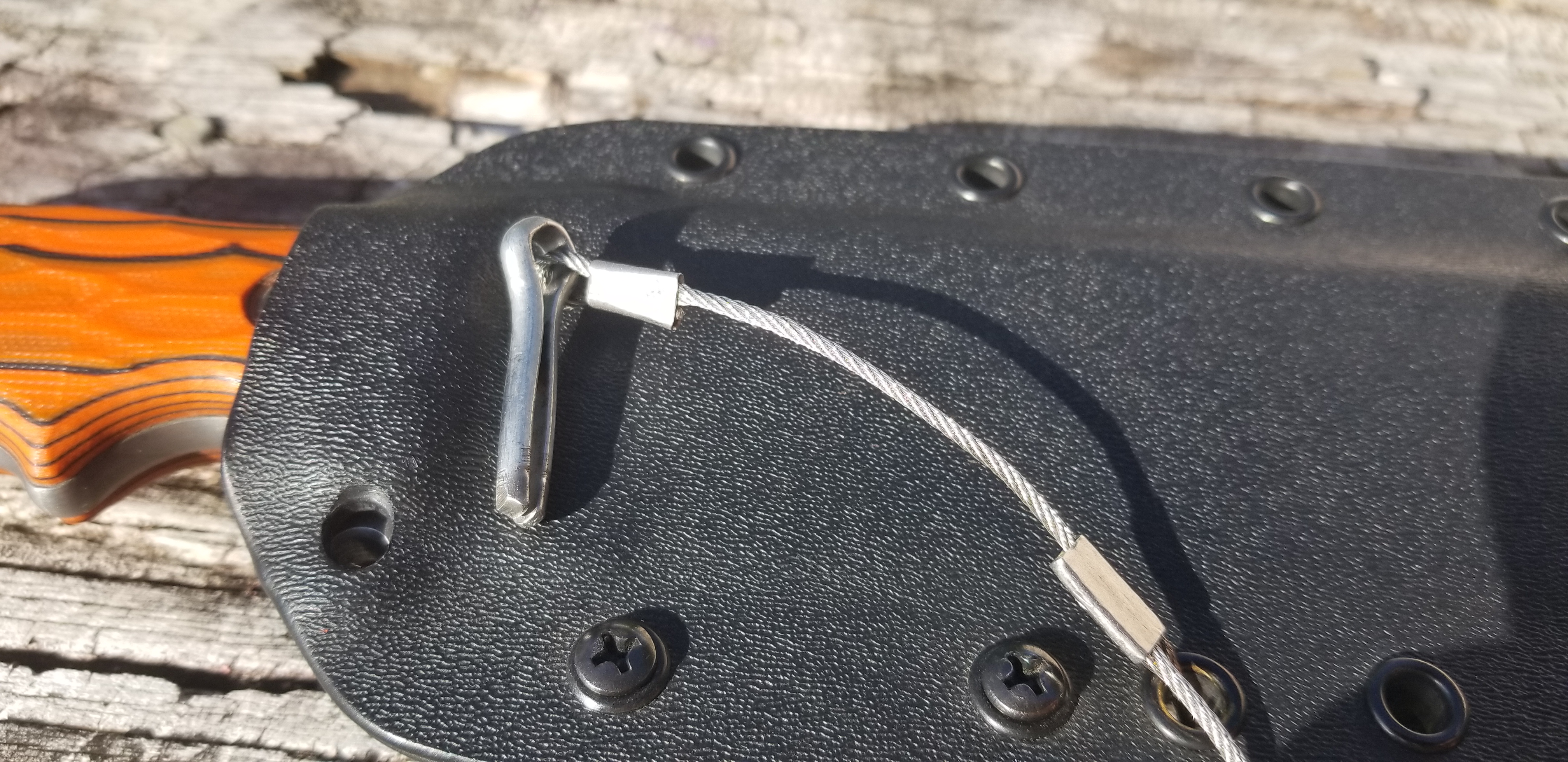

Hey guys.
If you need to guarantee that your knife won't fall out of a kydex sheath, I found it is very simple to do with a short piece of 550 cord. Any string with decent strength and small enough diameter to fit through the talon hole will work. I am assuming all Busse sheaths come with those.
Insert the knife into the sheath, thread the cordage through the talon hole, and come up over the handle to tie your knot. Make sure there's no slack. If the knife tries to come out of the sheath, the cordage going through the talon hole won't move. I hope this was easy to follow and I hope even more that Busse makers all put talon holes in their kydex so that this isn't useless, haha (mine was from David Brown)
Sorry if this is a well-known trick, I just thought of it.

if I'm picturing what you describe correctly, wouldn't you have to have two hands to untie the knot?

I don't think I can post photos from other makers here, but Winkler uses a strong stretch cord on his ax sheaths.
Its secure, easy to release (one hand). attach it on one side stretch it to the other at the tension you want and it is secured in a notch.
I have a lot of faith in this system...

I'm using 550 cord, and if I tie a simple shoelace knot it's still secure but very easy to untie with one hand. Pulling hard on one of the ends is sure to untie the knot, and from there you can just pull the cordage out of the hole, and there is nothing getting in the way of your drawing the blade. I've found it's easy to do with one hand.
