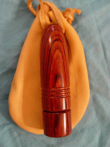

It just so happens I have an extra coco bolo fire piston and tinder container from Wilderness Solutions similar to the one above I bought for my son. He has expressed zero interest in it so if you want it I am sure we can work out a deal on some coco bolo for some osage. Especially if there is a Nessie pinned to it.
I can get you some pictures if you are interested.
Sounds like a possibility. The prototype is actually being mailed to me tomorrow. Gonna check it out and tweak things if need be. :D
Pics are good. :thumbup:
Ill take some pics in the day light tomorrow. It's used but only for demos. Pretty wood and the little tinder box is cool to.
