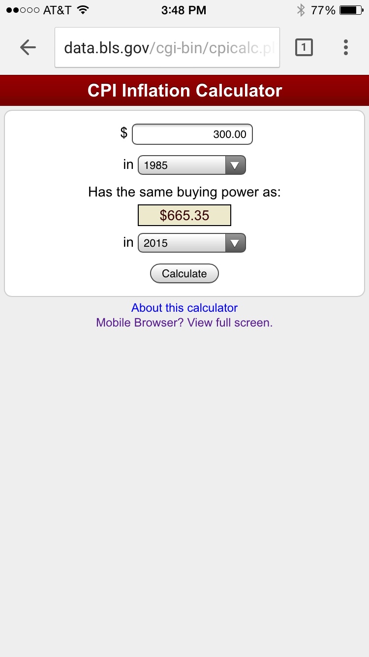

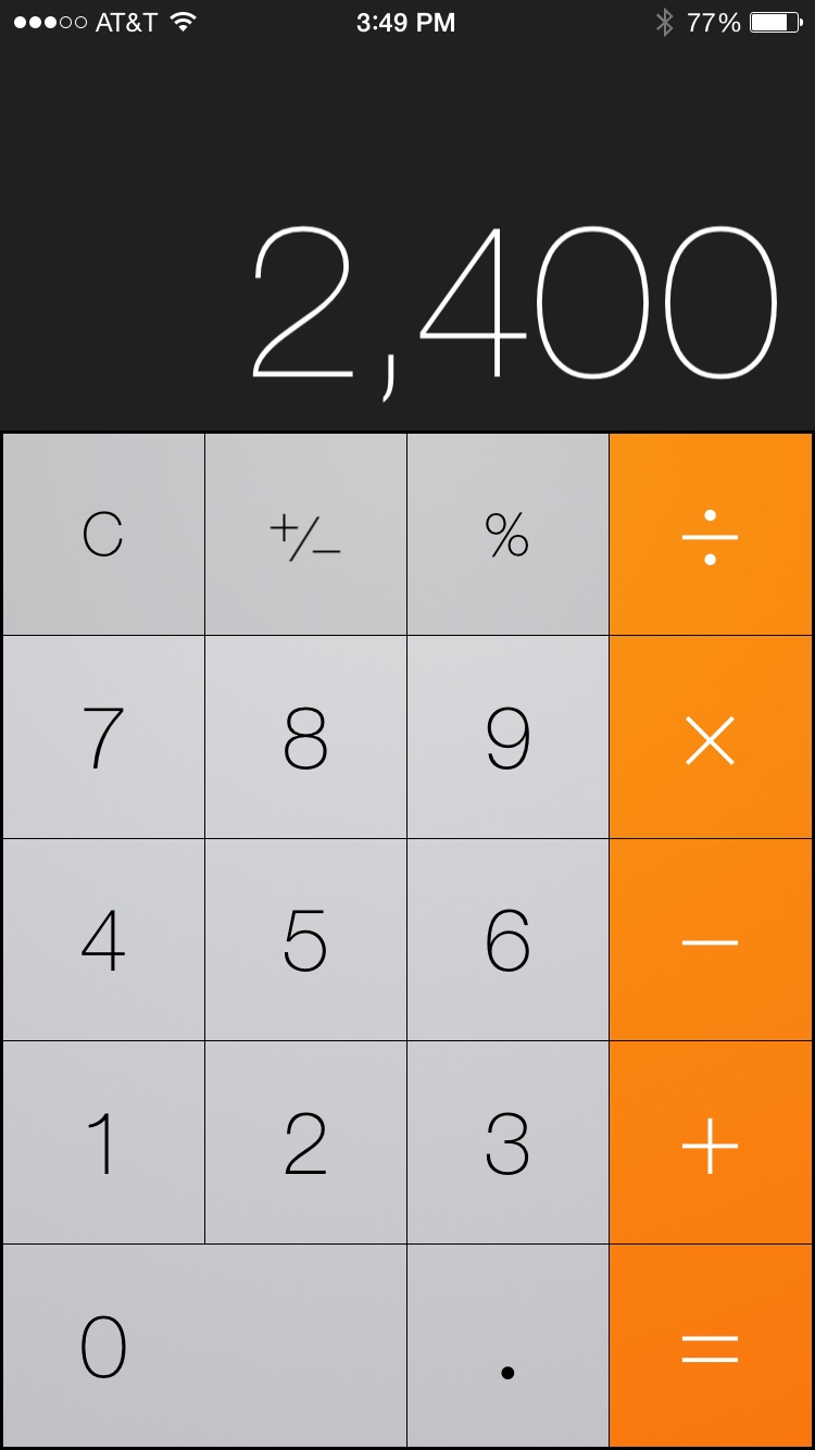

The things I'd do to possess those 20BF... The price you paid is outrageously impressive on your end too. It would run me $120 for 1 BF of much lower quality stuff at my local dealer. Granted prices change over 30 years with scarcity, over harvesting, inflation and such but nonetheless very impressive. Are there perhaps pictures of this "$30,000" log? I'd absolutely love to see such a thing.
Hate to double post but just a rough example of how great a deal those 20 BF were.
(conversion of the price paid 30 or so years ago to 2015 due to inflation)
(Price id have to pay if I were to walk into my local dealer and ask for 20 BF of the stuff my provider carries, if they even have that much available.)
