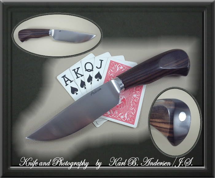

Looks like that integral "bug" done bit me.
Not sure which photo to post so I'll post them both.
I did like the Davy Crockett idea, but the other one shows the knife better.
A really nice piece of Macassar Ebony graces this 5160 integral made with my through-tang construction. This type of threaded tang and nut construction integrates the entire integral blade with the handle material.
I simply find the appearance and feel of these to have a certain grace that I can't ignore.
Thanks for letting me share!

Nice knife Karl. How do you file the integral for a flat surface where the wood fits flush? Always a gripe for me.
You don't.
Try to imagine this:
Forge the blade and then draw out the tang in as round a shape as you can. Diameter is not all that important.
Pay special attention to forging the tang STRAIGHT in line with the blade in all directions.
Drill a hole in a block of wood the same diameter as the tang.
Lock the block of wood in your cut-off saw.
Stick the tang in the hole.
Bring your cut-off blade down to where you want your shoulder to be and sloooooooooowly spin the blade and cut your shoulder.
If you need further explanation, get ahold of me.
I learned this from Ray Kirk, M.S.
Is that the trick you were talking about learning Karl? Man you make is sound so easy, but I it is not. It looks like you got another great one Karl, very nice work.
Yep, that's the trick and it's slicker th'n snot.
