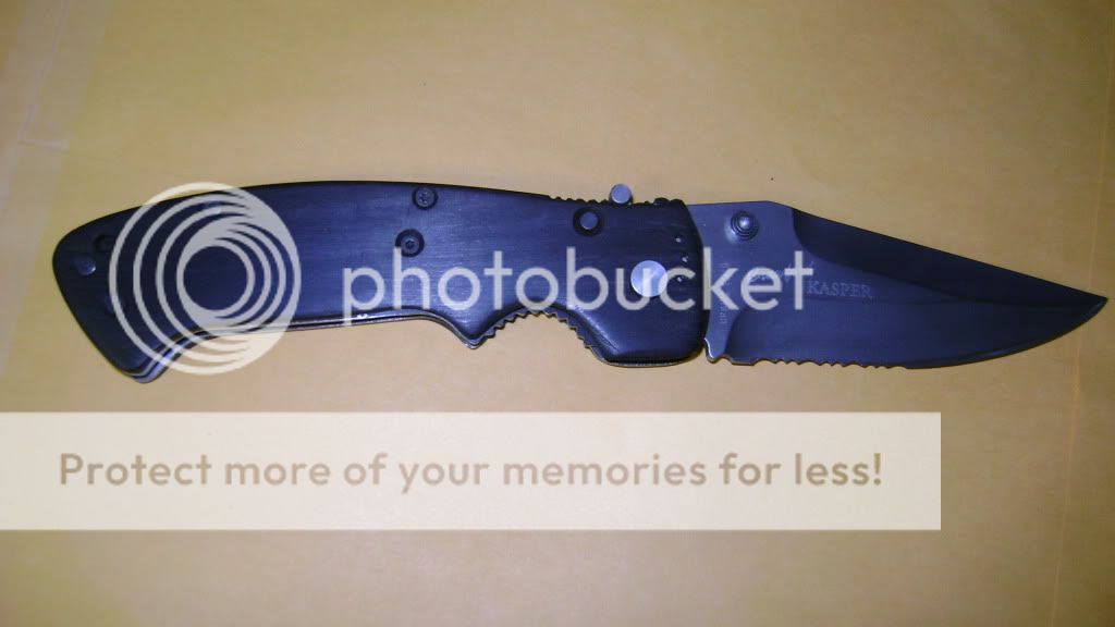

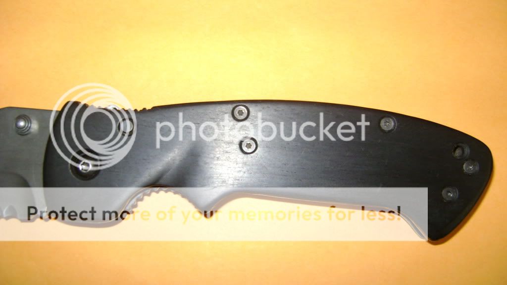

Finished up the Ebony scales for the CRKT Crawford Casper, now I just have to put a finish on them. Found a method used by a violin maker for the fret board so it should be durable, Ebony is hard to finish right.
Also got rid of the black coating on all the exposed parts, left it inside though, still have to polish up the spacer a little more...

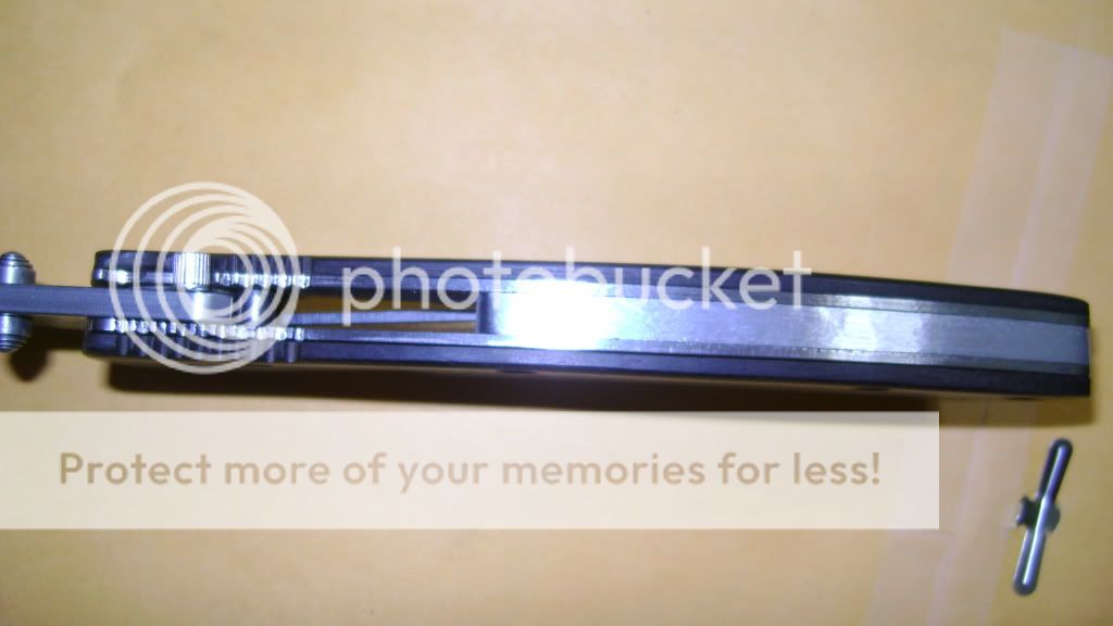

I went down to 400. I haven't applied the finish yet, its a process that will take more sanding and a couple of coats of raw linseed oil. Seems to be many ways to finish ebony but a lot of them do not work or do not last long. I got this one from a violin maker so it should last. Sanding them down with a Fein tool really worked well and didn't kick ebony dust everywhere, which would suck as the stuff is nasty. Got them down as thin as the originals so I could use the old screws..

Try to get a thin piece as sanding it down is murder unless you have a big belt sander. The dust is nasty, wear a mask and try not to get it on you as it can irritate anything it touches. Use very sharp tools, new drill bits, etc, its extremly hard and dense. As far as finishing it I haven't tried out the method I found yet so I don't know how that will go but I do know that some finishes will wreck it, it has a lot of its own oil so it doesn't mix well with some.

And now its finally done. I sanded down to 400 and sealed it with linseed oil. Its not a very interesting wood but has its own unique quality. I have some cocobola slabs, need to buy something else, or maybe the same knife as its now 20 bucks, one of the best bargains out there...its funny but they are still making this knife and now are doing wood scales for it...
