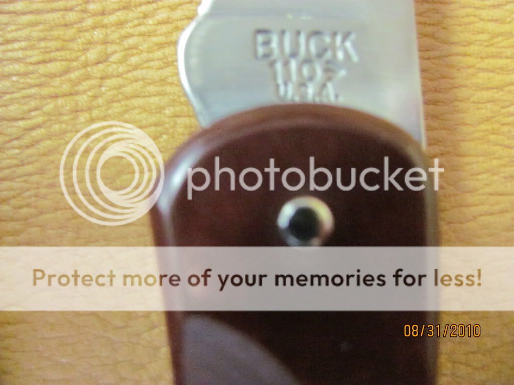

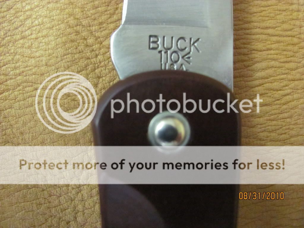

There is a 2nd generation Ecolite for the 110 and 112. Both of the orginal versions had the possibility of not snapping shut. I had the issue with the 112 but not with the 110. I have the new version 110 and just used it to dress 2 deer on Saturday-worked great.
That being said, as far as making sure you get the new generation, I dont think you have to stress about it. My 112 is now perfect. I cleaned and oiled the heck out of it and let it set overnight with alot of oil on the tang/pivot then cleaned and oiled once more with a normal amount and it's travel and snap is perfect. My only advise is if you are able to buy one in a brick and mortar, open the box and check it-mine came off of the bay and was sticking right out of the box. If it is ok at 1st, it will be ok after-just needs normal clean and oil from time to time.
Here is what the issue looks like
Old and new style pivots
old close up
new close up
Hope this helps

sweet, thanks for the input guys, and thanks very much fritz for the pics, those were perfect. the one i'm looking it is from ems.com b/c that's where my gift card is for (mods please remove if this is considered inappropriate posting)...the picture they show looks like the first generation, but so does every picture i've seen online at other dealers. do you know when they switched the second gen? is it likely that it's 2nd gen but the pic just isn't updated? also, in the pic it looks black but it seems that green and red are the only colors produced unless this is a new or special run...my guess is it's green but just looks black in the pic. what's the grip like on these babies? and bear claw - what "web special" one are you talking bout? thanks again guys!

The closing issue got kicked around on here quite some time back. I believe it was about the time Buck made the change to Post Falls (instead of Houston :rolleyes:).
One of the solutions was to hose it down with WD40, Work the blade a bunch, blow it out with an air compressor and repeat as necessary till you get the factory gunk out of it.
Then wash it with soap and hot water as well as you can, again blow it out, then a drop of light oil.
I discovered moms sewing machine oil. Or the old stand by 3n1
