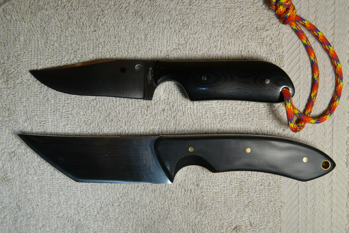

As others have said , the HANDLE is really the limiting factor for me . The Micarta Street Beat ( the smaller pictured) has ~3 5/8 " handle that 's very comfortable and well designed . Blade is just over 3" cutting edge .
