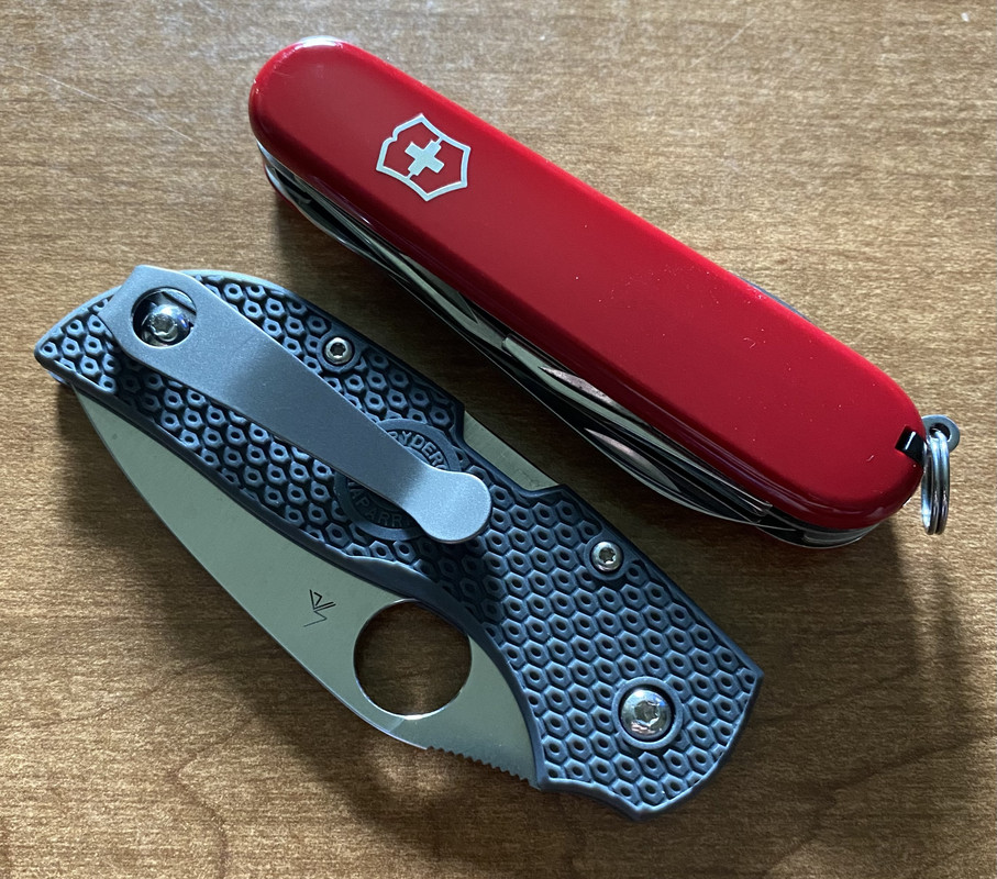

Still "wielding" the SHF.

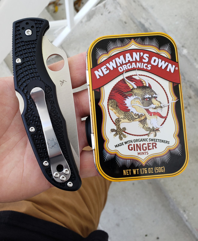

Ordered a satin pocket clip from Spyderco. They sent me the wrong clip. I took matters into my own hands.

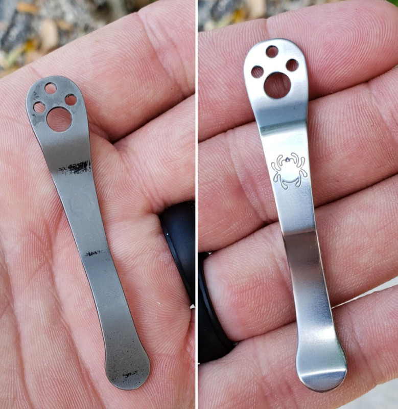

I stripped the factory pocket clip first.

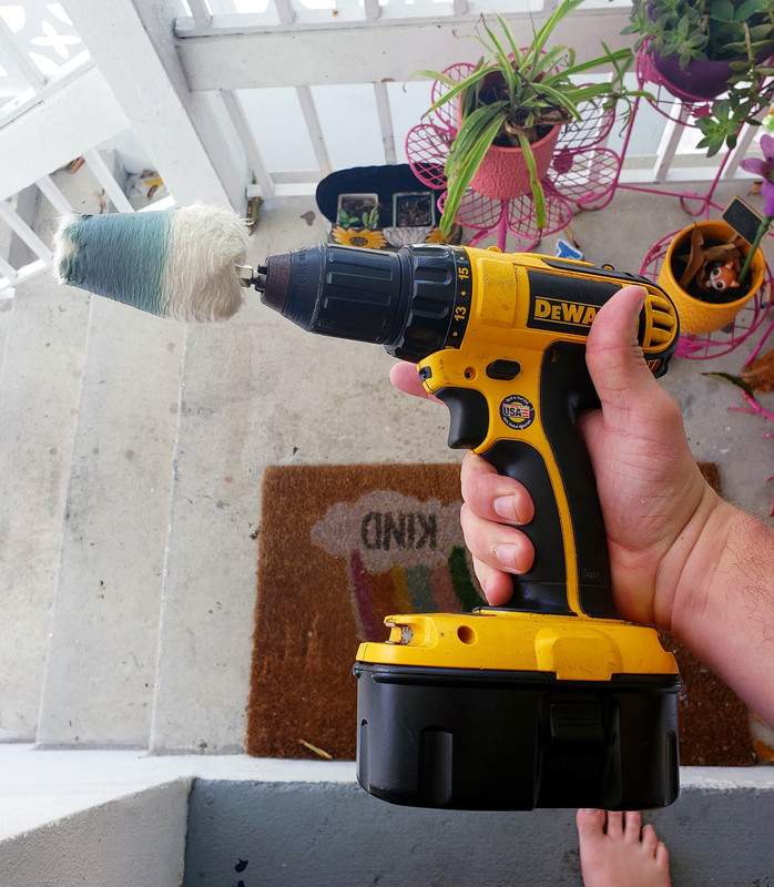

I went to Harbor Freight and bought an inexpensive buffing wheel. The wheel by itself did not touch the Clip. I used my green stropping compound, applied to the wheel, and went to work.

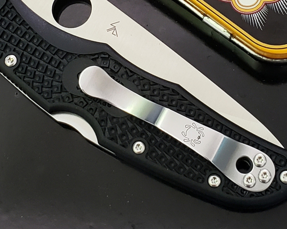

Ten minutes later I had a factory Endura pocket clip, buffed to near-match the rest of the knife. I am in love. 😍
The reverse side of the clip to see the difference.

I love it when a plan comes together. I throw mine in the campfire briefly and can get some interesting results. Nice work !
