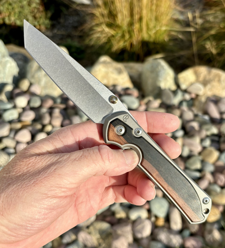

Got my large 21 back in service! I had it clamped up in my KME for an embarrassingly long amount of time because I had reprofiled it to 15 degrees per side using my 300 grit KME diamond stone, got about the most perfect edge I've ever gotten (on the flat), completely deburred except for a tiniest little bit. Then I had to go to sleep and had lost the motivation the next day. Then, the edge was so almost perfect that I was a little intimidated to go back at it. Well yesterday I said screw it and just put my 5 micron diamond covered balsa strop to it lightly and finished her up. So it's a 300 grit diamond finish, with just a hint of 5 micron diamond compound. It's one aggressive edge! It'll chew right through the skin on your finger by barely touching it, while cleaning up the Sharpy, I'll tell ya that! I left the front on the tanto not so perfect so that I can use it as a scraper type tool.

BTW, I've often wondered what's with the flame ano at the lockbar cutout?

The ano…well, mine got some slight “lockrock” because of light lock-bar strength so I needed to adjust it. Only way to do that on an integral that I know of is with localized heat. The plan was to reblast the handle, but the coloring turned out to look pretty cool, so I left it as is.
