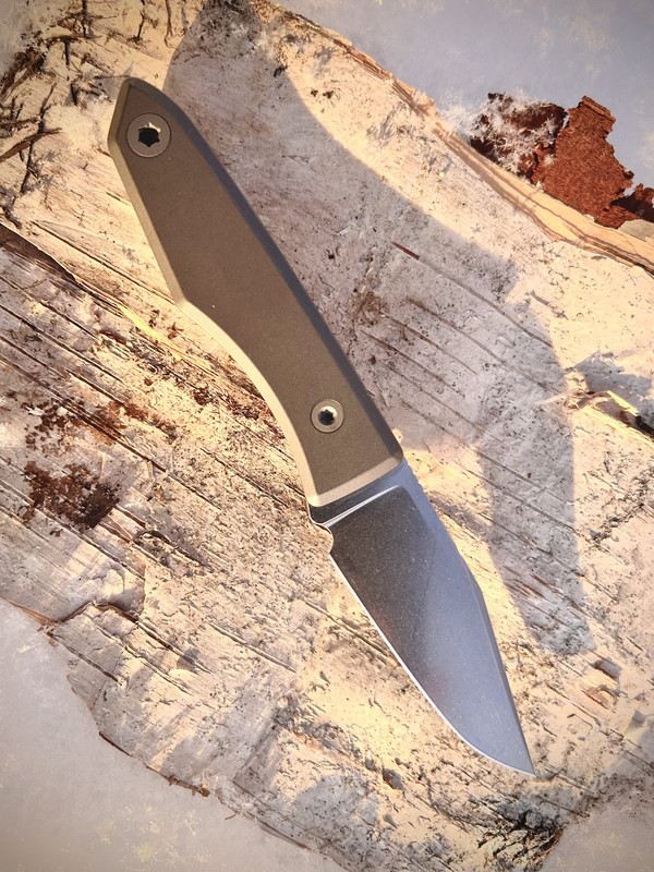

And then I meandered around the house and yard with these yesterday. The automatic was my grampas.
