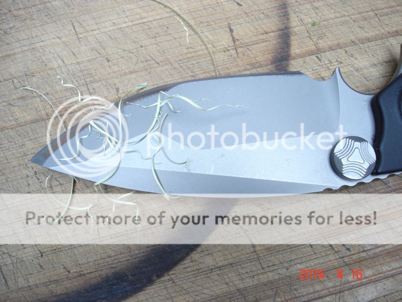

They will vary quite a bit. The grind lines on my are not even, and the nightmare edge grind left the edge with different edge angles. Here's a reprofiled edge at 30 degrees inclusive. To the extent that your edge has a narrower bevel, it will have a steeper angle than 30 degrees.
