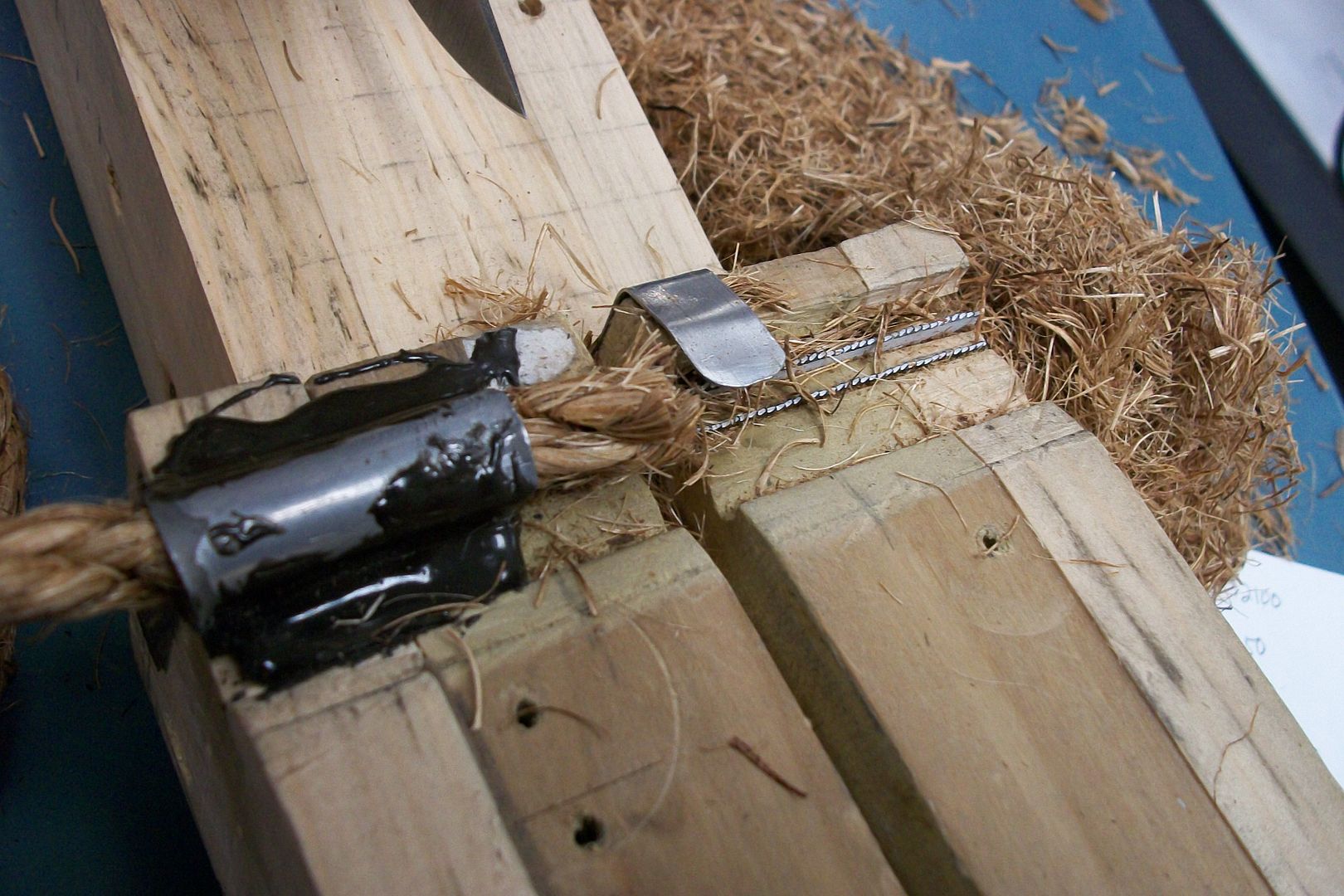

Quick update - have switched to 3/8 " manila rope for this tester, seems to be more consistent than sisal based on what's available at HD locally (Everbilt, both types). Have begun to retest some of the knives I used previously, the numbers are a bit lower, edge seems to degrade more consistently. Swapping ends and coils should tamp down any remaining variation in the numbers introduced by the test media.
And a picture of the current sled arrangement. Feed tube JB welded to the sled, clip on opposite side pins the rope against a pair of recessed saw blades so it doesn't want to pull back into the gap. I'm able to make cuts at a rate two or three times faster than before.
