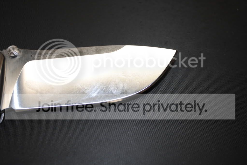

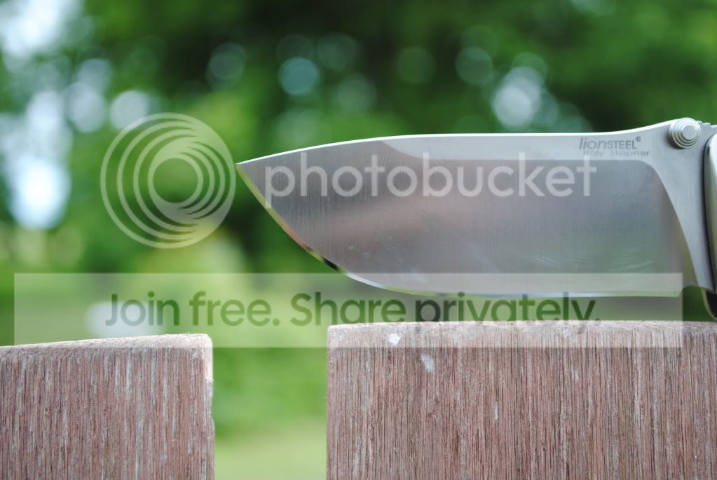

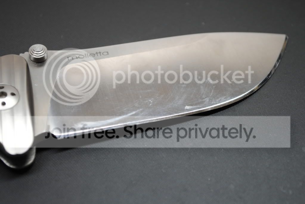

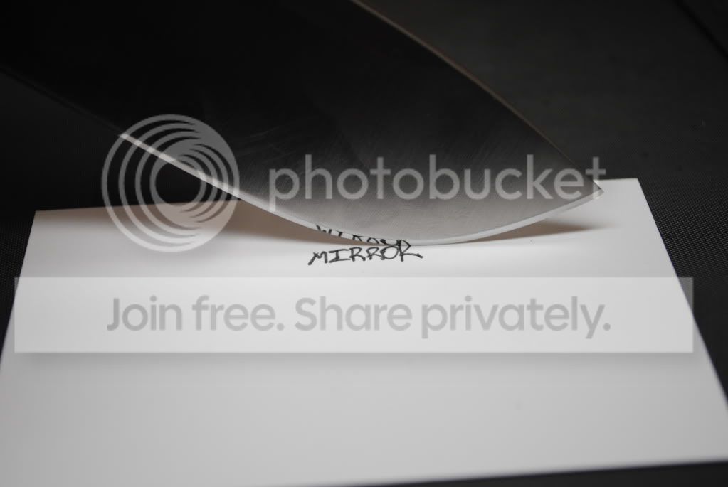

Here's some photographic clarification:
The smudges and scratches are from actually using this knife, it is not a safe queen by all means!
1000 Grit Waterstone finish - Muddy mirror, under closer inspection you will see some lines in the finish yet.
3000 Grit Polish Tape - Clean mirror, under closer inspection you can't see any sharpening lines, true mirror.
