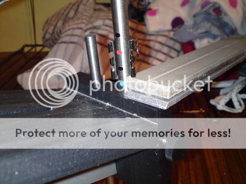

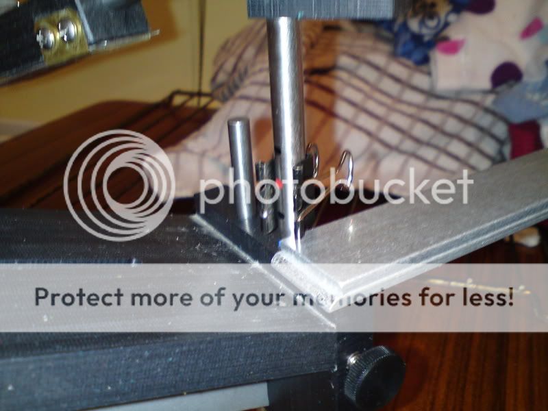

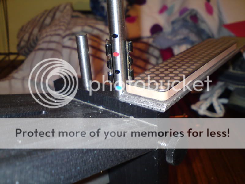

I'll try to explain.
I set up my edge-pro using a polishing blank, thinnest stone of the set and consistent in height. Here I set the blue dot as my mark. You will see various stones move the blue dot up or down, but my angles remains consistent and I'll end up back on blue with the polish tapes.
Once I've set the arm at the desired height, either going on the dots or using the sharpie marker, I take my blank and hold it by the arm. I then put the bulldog clip on the arm and sitting on top of my blank. Try not to bump the clip from now on!
Loosen up the locking pin and slide the arm up, but the stone you wish to use against the arm and lower until the bulldog clip again touchs the top of the stone. Using the eze-laps this position is the same for all the stones. Using the water stones with varying degrees of wear on them you will reset for each stone.
This puts me on the bevel each time I change stones, there is a slight variance but it's really very small. It also means I can go from eze-lap to DMT to polishing tapes very easily. Hopefully the pictures show what I mean.
The blue line shows me where the four inch DMT EEF ends
and the various stones and plates
Hope this makes it clear lads.

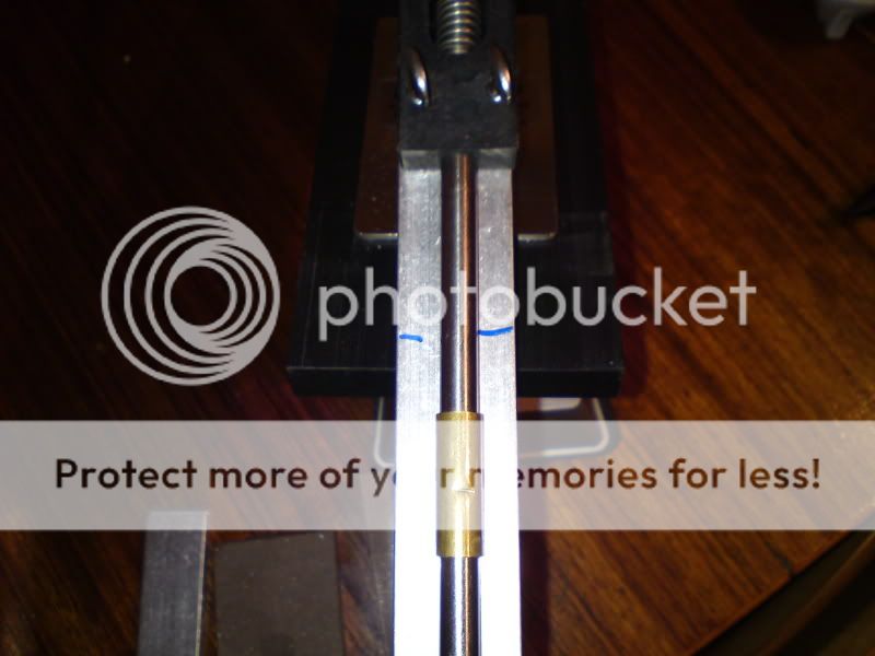

Haha... pretty cool. I figured out the exact same method. Here's a pic for both the Pro and the Apex....
On the Pro, the stone goes between the clip and the base. On the Apex between the clip and the arm.
I then switched to a "drill stop collar"... little more stable. Here's a sample with the Apex showing a thick, then thin stone...
Great minds think alike!!
