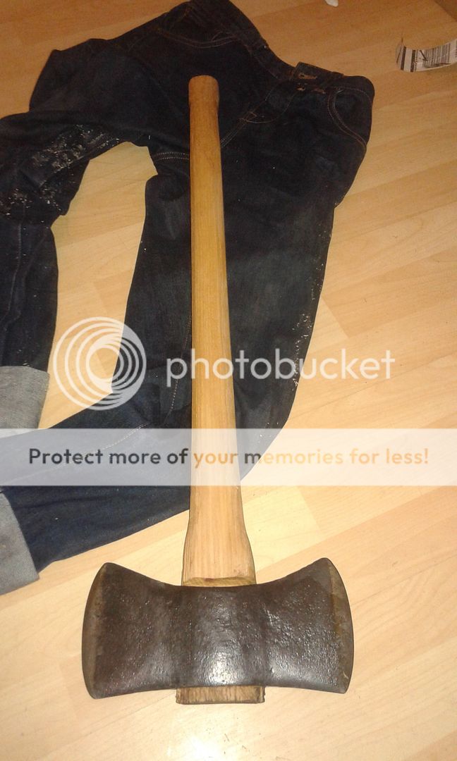

Well one of my parcels have arrived, and I confirm that vintage American steel is impressive. The difference in hardness between my Kelly double bit and my modern Council Boy's axe is astonishing. It is very difficult to sharpen with a file and I'm resorting to my knife sharpening stones.
Good for you! Likely not much hardened steel left in this old girl, and the exterior was rust-hardened to the extreme, but now you've got yourself a real axe.
From the ring of the steel I'd guess there's plenty of life left in this old girl. If I compare this to an equally oxidized 18th century Indian tulwar I bought a while back, this axe edge is significantly harder.
