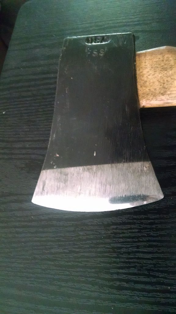

Perhaps having most of the axe head made of iron (or softer low-carbon steel) was a factor.
No doubt, as 1% carbon steel would make for a fragile eye. When a single homogenous steel is used for the entire axe (as a cast steel axe) then a compromise must be struck between strength at the eye and hardness at the bit. Differential hardening isn't limitless in its ability to produce different qualities along the length of an axe.
Returning to another recent thread, this makes a case for the insert method vs. the overcoat method as encasing the hard bit with softer steel adds toughness to it. The advantage in overcoating is economy in production.
