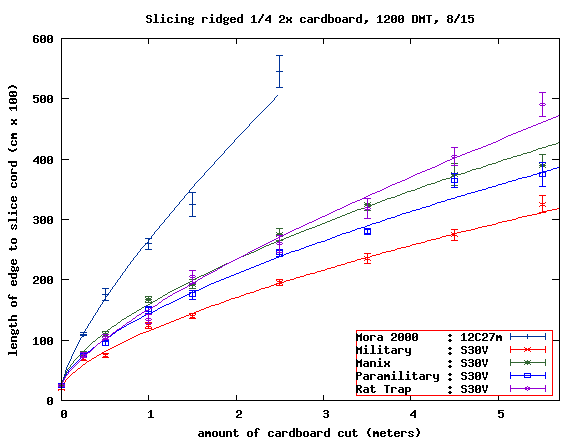

As I noted in the above, the main purpose of that comparison was to show the difference between edge stability and edge retention and how the exact same blades could therefore have very different cutting lifetimes even when the media cut was the same and the edge angle was the same depending on how the media was cut and the finish used. I was origonally going to use D2 and 52100 but used the Zubeng light utility as I need to benchmark it anyway.
Yes, various materials test would be use as these would allow the formation of a model which determines how these properties are reflected in the performance. However the actual performance of the knife is obviously of value independently. If a knifemaker describes the performance of a knife he has made it is obviously useful knowledge even if he doesn't know the hardness, carbide size, grain structure, etc. . Primarily of importance from a user point of view is of course the performance directly.
By the way I didn’t say the scratch test was the best or even a real good way to test hardness, but it is better than nothing, and you can tell a difference of 67 rc from a 60 rc by doing it.
A VG-10 blade from Spyderco (59 HRC) scratches Alvin's 1095 blade (66 HRC), the softer S30V blades I have (based on how they deform when cutting hard materials) easily scratch the VG-10 blade. Thus if you ranked hardness by that scratch tests you would have the blades in reverse order and be very misinformed. Based on HRC tests Wilson has done the softer S30V blades are likely 10 points softer than Johnston's 1095 blade however the very hard vanadium carbides will pretty much scratch anything, this is why those steels can still haev a very high wear resistance even when soft. It should be obvious scratch tests are problematic on non homogenous materials, for example both cardboard and carpet can scratch blades, even Wilson's and Johnston's which are hard/high carbide, but this doesn't mean cardboard/carpet is harder than the knives. You also have to be aware of scratches which just remove the surface oxidization and thus leave a bright line because that patina is really soft which is why carbon steels scratch fairly easy, as well easily scratched are rougher surfaces as they are weak and can be smashed down more readily. You also need to consider the difference in the contact geometries, a very fine point will much easier scratch a surface than a blunt one as the contact pressure is much higher.
As I noted you are basically checking wear resistance not measuring hardness, this is actually one of the ways wear resistance is measured using a diamond pin. The scratch test for moh hardness works because you are looking at a very coarse change and you don't have the effects you have in steels where you can have a mixture of moderate hardness steel matrix with intense hardness alloy carbides. If you wanted to check hardness then do a direct hardness test which means measure the resistance to deformation because that is what hardness actually measures. Take the edge of a file (or glass, or ceramic, something harder than the knife) and put it into the edge and then load the spine of the knife and measure the indentation. You would of course have to have the geometries very close and given how strength and stiffness are strongly above linear you would be only able to make a coarse estimate without basically reinventing a hardness testor.
As I noted you obviously can infer this from use watching how the edge deforms and the level of edge retention assuming you have used enough other knives. This is why it is immediately obvious that machetes or cheap stainless kitchen knives are fairly soft. You can also estimate it from the responce of sharpening. The guys who have had Wilson reharden blades for example will note it sharpens differently and this experience then allows them to judge the hardness of other steels. But again this a nontrivial process as you also have to take into account alloy composition and geometry.

I was also surprised at how fast they both dropped in sharpness early ....

The two lower performing Spyderco S30V blades are significantly softer than the Military by use. The Manix in particular actually had the entire edge take a dent and be pushed to the side. Now if you look at the results of the fitting then the A value is Manix > Paramilitary > Military which supports that hardness ranking.
It would indeed be useful though to have them all HRC tested and if you lived within driving distance I'd likely be constantly hassling you to test them. But at shipping costs of about $25 a knife then I have to weigh that information which would be a slight refinement vs actually obtaining more knives, more material to cut, etc. .

This makes me wonder if it's possible that I'm working at or near the limit of edge stability for this blade - so where finishing only with fine ceramic the edge is reasonably stable, further refinement exceeds it.
The edge stability of the low alloy tool steels is very high, they are all class I (Landes) when properly hardened, however that knife isn't going to be of that level as it is under hardened, however it should still be very high compared to almost every modern knife steel.
By this I mean not due to any irregularity caused by stropping, but simply that so fine an edge is created it not only fails quickly but does added damage in the process?
Yes, if the edge fails prematurely due to not being stable enough the B coefficient can actually rise above 1 which means that the rate of blunting is actually proportional to the amount of blunting which is indicitative of heavy deformation/fracture. This is why burrs are a problem because they crack/tear off and can be smashed back into the edge or just fatigue it as they are bent repeatidly until they fail. Just bend a butter knife back and forth and see how much metal back from the point of failure is heavily damaged.
Also leading me to suspect this is right near the limit of edge stability, increasing the microbevel by about 2 deg/side eliminates any tendency to do this.

What I find most interesting is that a couple Eriksson 12C27M blades I have have no problem with the same 10/15 edge geometry. Frosts laminated blades with stated 61 HRC core also do fine like this, as would be expected; BK11 and Bark River I have with similar edge geometry also no problem. VG-10 (Spyderco) on the other hand I've always found needs a microbevel >15 degrees to hold a fine edge well, at least for this kind of work, and simple carbon steel blades hardened mid-50's I usually finish with a 20/side microbevel.
O.K. that's exactly what I was wondering. This would seem to have some interesting implications when comparing blades, I assume you could see some startling changes in relative performance of two blades as you adjust edge angles and finish.
So it is 10/17.
Right. Just a very minimum microbevel at 17/side and the problem doesn't seem evident at all.
Thanks for the reply, Cliff. Your extended cutting ability model now takes on more relevance for me, and is very helpful.
This all makes sense given the expected properties of the steel. VG-10 is much more coarse than 12C27M and the softer carbon steels are much weaker and the edge needs to be more obtuse to give it the necessary strength. It is rather interesting to note that this was one of the myths that Swaim first exposed.
As with all myths there is usually some element of truth. When Swaim reground edges and lowered the edge angles he got much better cutting lifetimes for a number of reasons. This directly opposed common perspective at that time which is that if you went from 22 to 15 the knife might cut better initially but would soon drop behind the 22 degree blade, this really isn't true for most materials people cut.
You can refine this further by making the bevel more complex. Instead of simply going from 22 to 15, go to 15/20 and you get (for the most part) the cutting ability of the 15 and the strength of the 20. This of course is no different than the natural extension of just putting an edge on a bevel and not simply taking the primary grind right to the edge.
Indeed. What the above should make obvious isn't simply the performance of those two knives but a general point about how edge retention is very dependent on how materials are cut and for how much. You can easily have a case where blades are not significantly different or are radically different or the difference even inverts by simply changing the grit, the material, how you cut it, and of course the angle of the edge. This is why I would like to see more specific statements rather than "BT-3X has excellent edge retention." because that is like saying "The RangeFinder has good balance.". The statements are undefined.
